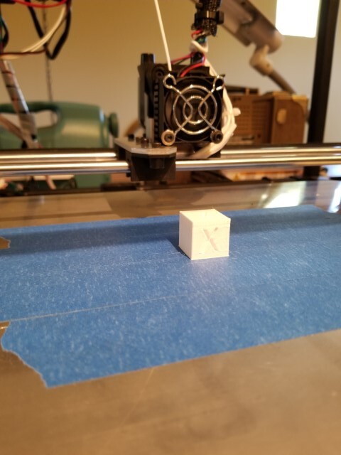

First print!
(Actually the 4th! First incorrect calibration on the extruder and Y axis. They were both 50% off for some strange reason. Second print failed after the bed thermocouple connection came loose. It is a straight berg and will have to replace with some type of locking connector. Third failed due to the stepper drivers over heating. I did not put a cooling fan on the board.)
This was sliced with Cura stock settings. I have not done any fine tuning.
