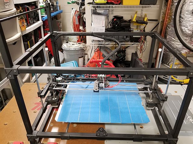

Here is what the printer looks like now.
The work area is 12 inches x 16 inches x 10 inches. It is made to be modular and the height can be increased. There was a 14 inch Z axis kit but I do not know if it is still available.
I have not tried to turn it on so I do not know what does or does not work.
There is are lot of fixes that need to be done from the original design to make it work more efficiently and safely.

Overview of the whole printer
whole printer

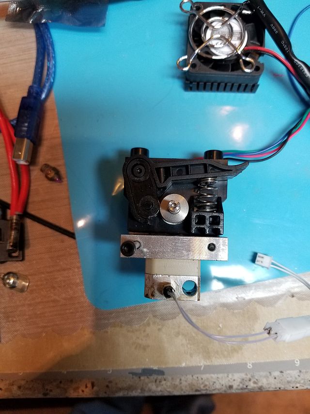

So today I took the hotend apart. It is very compact. I am not really sure how well it really works but for right now I do not feel like making any adaptors just yet. The stepper is 0.9 degrees as are the rest of the stepper motors. I know there were complaints on the stepper performance but I am willing to see what the fuss is really about before I start replacing them and having to make brackets and replace pulleys.
I found a MKS Gen 1.4 controller board in my parts bin so I am going to use that to make everything go. Once I have it running smoothly, I will see about a nice 32bit board. I had to order new 24V heaters because all the ones I have are 12V. I also had to order some 24V 40 mm fans.
Here is a picture of the hotend.
he2

  1. I rebuilt the original extruder with the updated parts from Reliabuild3D. The only issue I see is that the PTF tube is a little long so I will have to shave the nozzle down about a 1/32 for a flush fit on the hot end. Since I am keeping the 24VDC operations, the board did not have a 24 VDC output for the hotend fan. There was an additional spot for a 24VDC connection that is always on so I used that. I could have modified Marlin to use E1 but did not want to mess with it. I did a PID tune on it and it stays rock steady with only a +1 C fluctuation now and then. I will see about modifying the printer with another hot end at a later date.

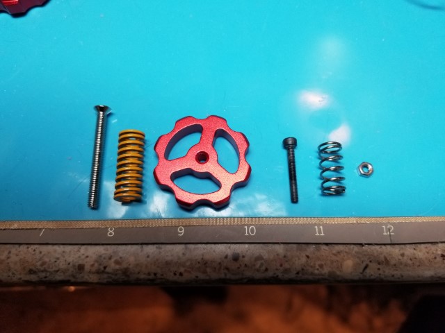

  2. The bed heater works great now that I used 3M 468MP to adhere it to the print bed and insulated it with a sheet of cork. I used 16 GA silicone wire to connect the bed to the controller. I also modified the way the bed connects to the Y axis for leveling. For some odd reason, it did not have knobs to level the bed and both ends were threaded so it was not really user friendly. you can see below what I used in place of the stock parts. The only trade off is that I lost about a 1/4 inch of Y travel at the front of the printer where the adjustment knob hits the frame. I can always get or print smaller adjustment knobs. I had a piece of glass that was the correct size for the bed.
