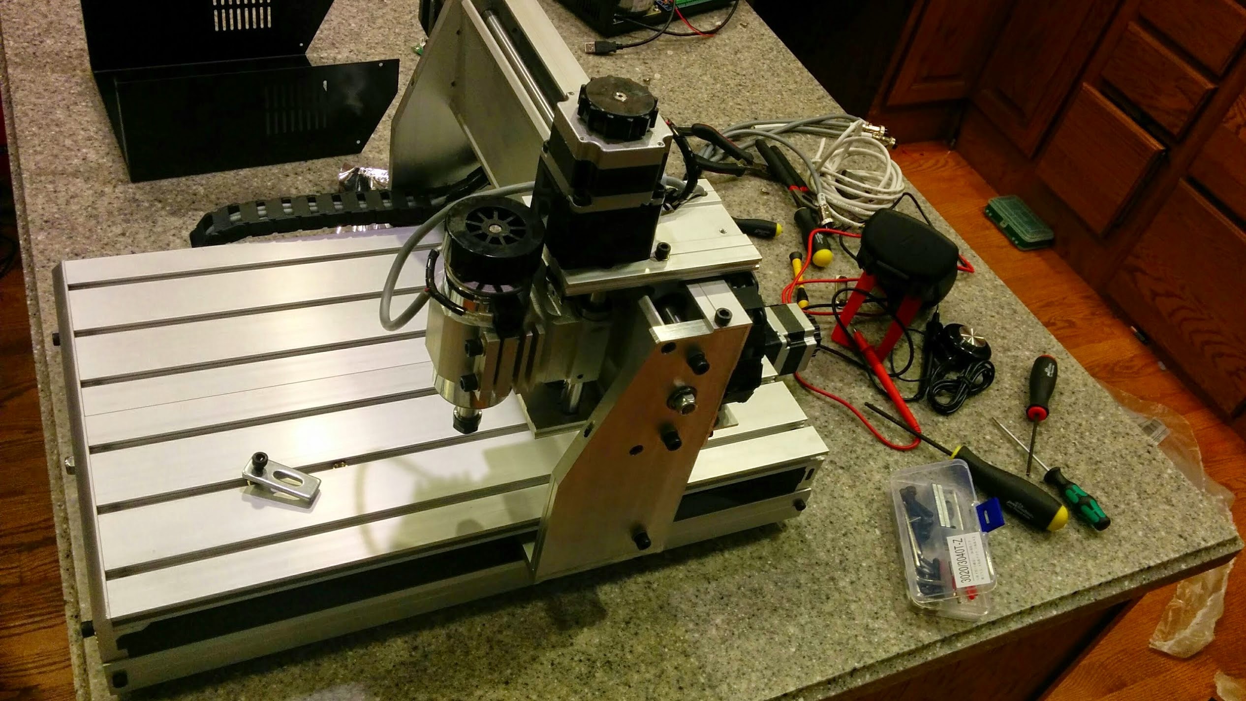

@Riley_Porter_ril3y just got a new 3040. Apparently there are 1000x more of these out there globally than any CNC machine. He’s ChiliPeppr/TinyG’izing the machine by tearing out the parallel port board (Mach3 driven) that comes with it by default. I like this idea so much, I’m gonna go do the same thing.
That is indeed a nice machine. Given its price, if we can get this working with tinyg and chilipeppr, I think there will be a huge market.
Its already working my friend. Hmm I will post a pic on the community to show you.
its up.
Yeah I saw. Now I definitely want one so I can mill out aluminum.

The spindle is lacking IMO. Its a bit weak. But the setup is solid for sure.
