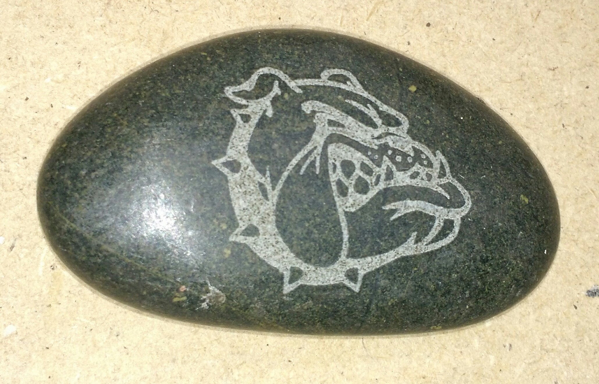

River Rock engraving 300mm/S 4ma
That’s super cool!!!
Thanks +Peter van der Walt:slight_smile: when China gives you lemons :wink: make lemonade :stuck_out_tongue:
+Peter van der Walt​ cardboard is your best friend with the stock software I cut out a duplicate of my blank and use it for alignment by using the border selection then click the preview button and it traces out where my image will be placed. It makes alignment alot easier
+Peter van der Walt except repeatability, I can’t remember why, but it was not always the case, but at that time, I lost so much time running after the parameters, so glad it’s in the past.
I would really love to see what kind of results I could get with a unit from @FabCreator ​ on various projects. I think I have more fun testing what materials and surface finishes I can work with more than anything
