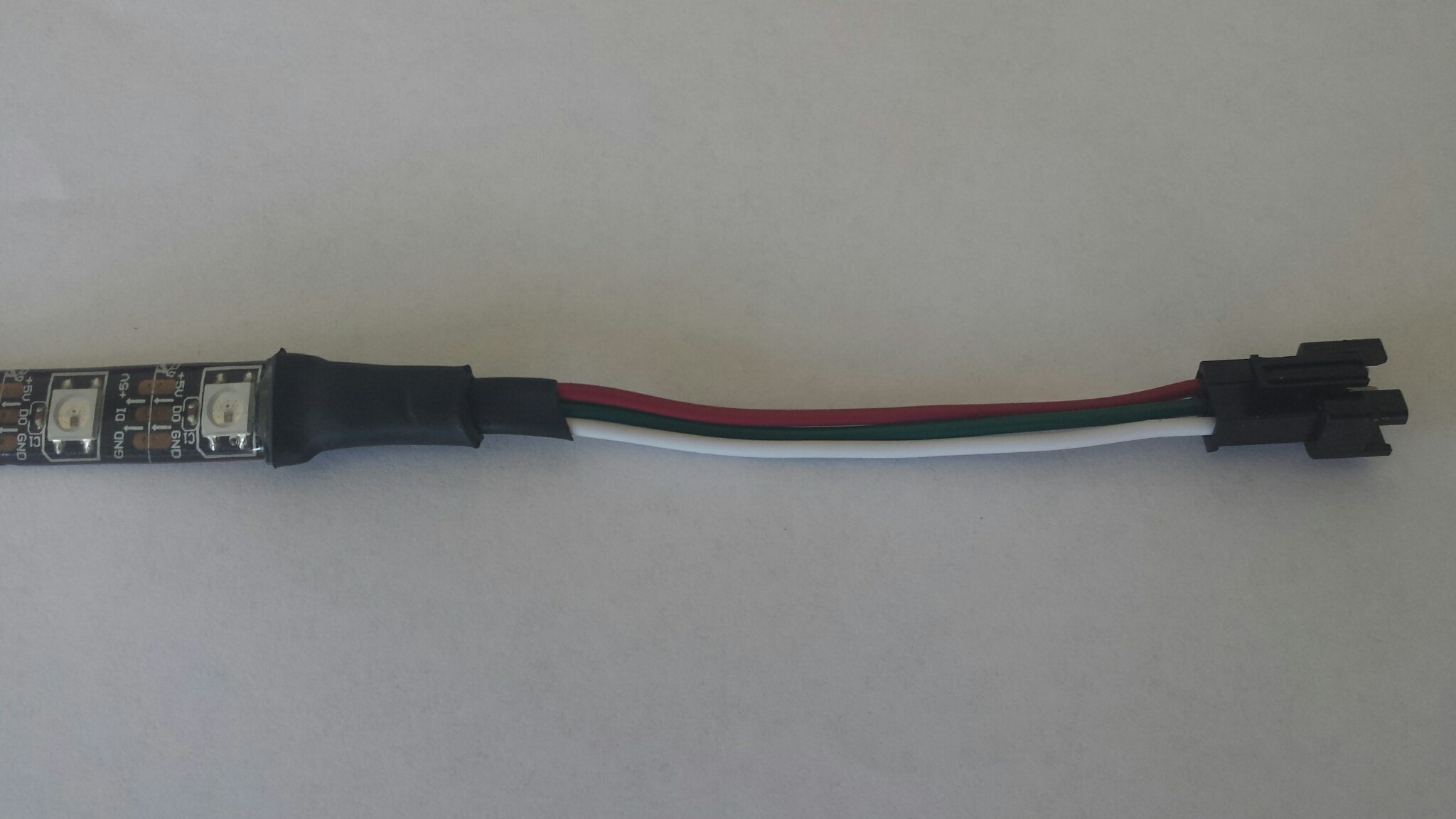

Robert Atkins . Sample pictures how i used heat shrink for ledstrips.
@Robert_Atkins . Sample pictures how i used heat shrink for ledstrips. As mentioned in the comments of you post. An extra transparant heat shrink on top also covering the first led would even be better.
Yup, that’s the approach I’ll use for the 30 LEDs/m “in silicon coating” strips I’ll use for my jacket project. It’s the 144 LEDs/m “in silicon tube” that’s giving me grief currently. The latter requires about double the size heatshrink (which shrinks unevenly) and has about 1/5 the size solder pads, making a solid solder joint difficult/impossible.
