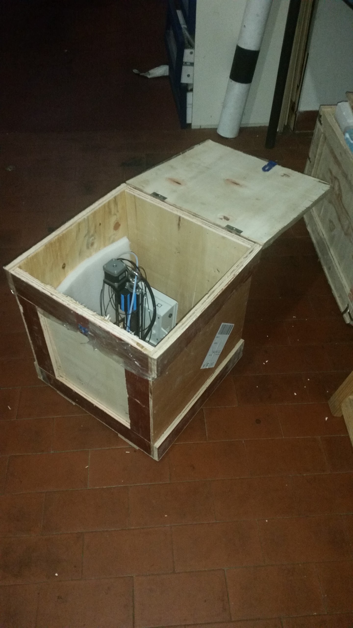

Ok yesterday Mauro my lab friend arrived with this new toy…
that are Robotdigg scara printer :
Final cost with tax and less of 500euro arrived fine boxed and just mounted/tested.
Before start see if all mounted fine and only adjust a tension of final arm and adjust one L support moved during trasnport and no permit rotation on base. easy fix…notthing complex.
