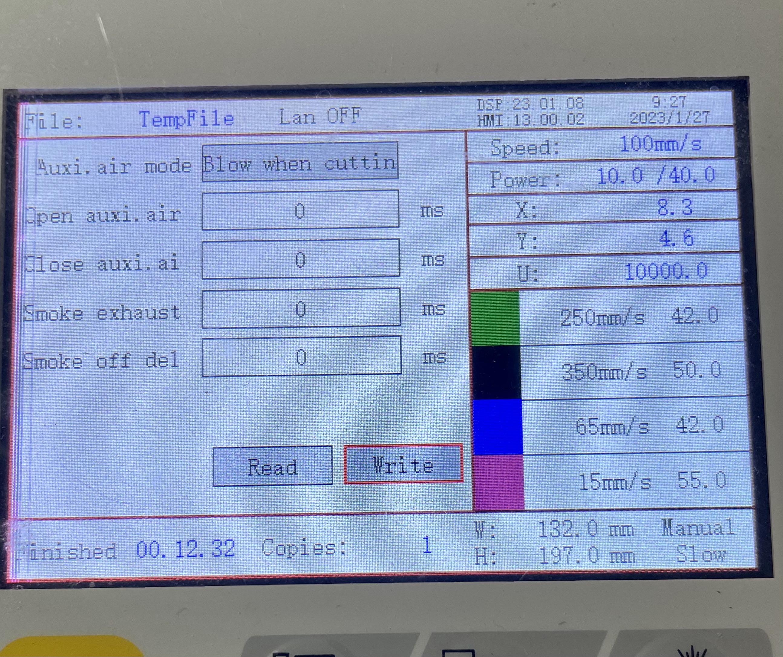

In LightBurn, under Machine Settings, I had set Enable air-assist output to True. I had also turned on the enable air-assist in the layer settings.
The laser has a KT332N Rudia controller and I finally figured out that there were conflicting settings in the vendor parameters that LightBurn was not accessing. Had to set (Menu–>Param Set–>Auxi.air) the Auxi. air mode to Blow when cutting and set the Open and Close times to 0 ms. I now have full control through LightBurn. :tada:
