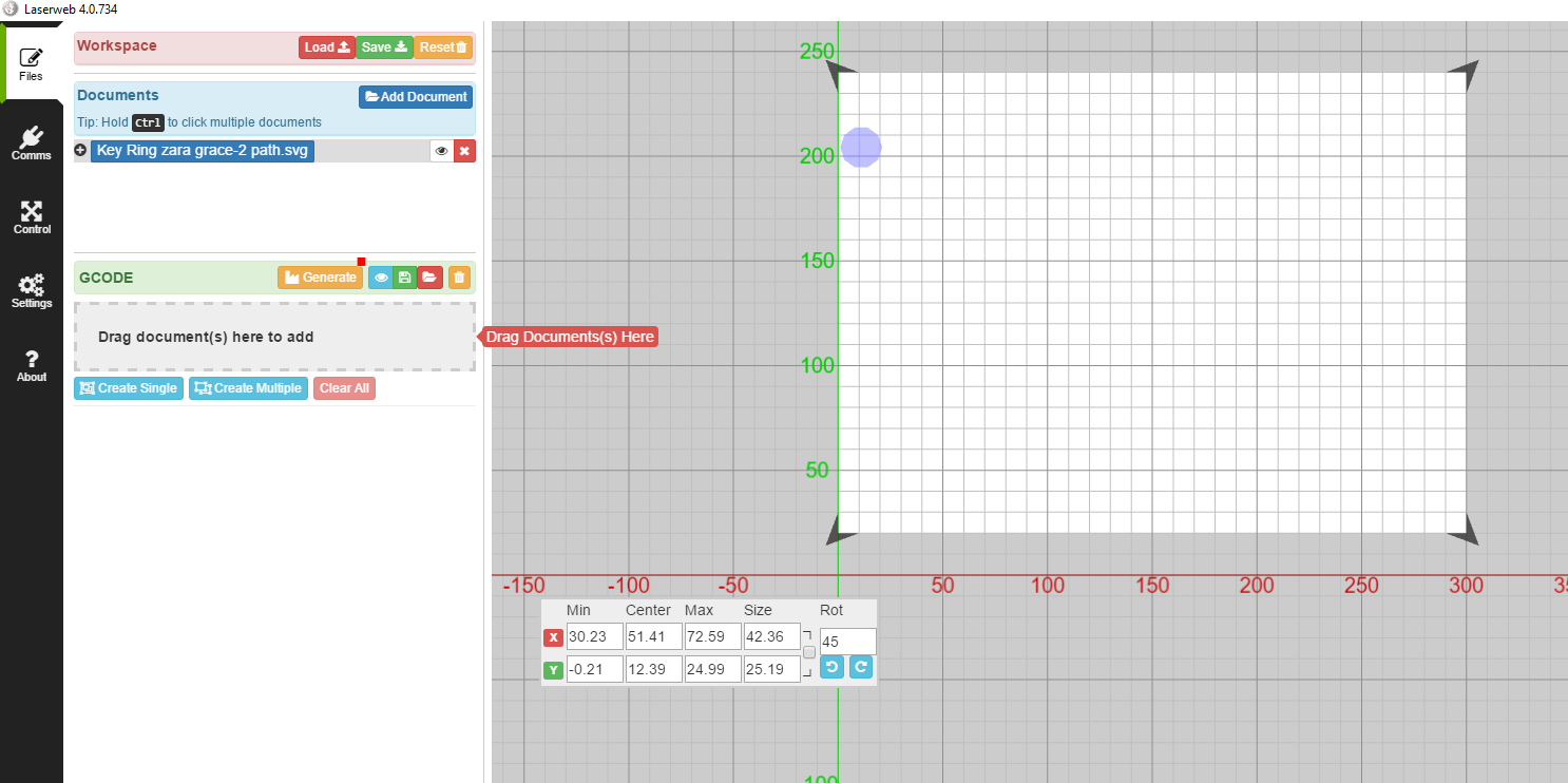

When I have completed a job and close the files down. Delete the G code but when I come to load a second job and nothing shows.
The “show documents” is ticked but doesn’t show the file… see screen dump
To resolve it I have to close LW down then reload it again. then the files will load and show.
It appears to be after a job has run on the laser, I can load, delete and re-load any file but once the laser has run the job it won’t load and have to reload LW.
