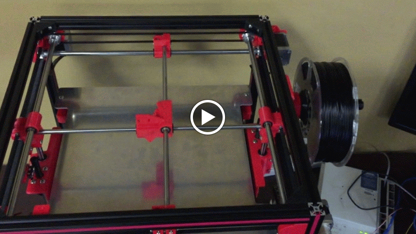

Running at 150%.
Oh come on! See anything wrong with carriage? Guess I will start fixing that now…
Gotta run before you can walk!
Is it backwards? Sure runs fast though
Might never run that fast again. This really bites!!!
@Vic_Catalasan Yes, its backwards…
Alright. I’m done pouting…
I think it’s back to normal. That was a pain though.
@bcrazycramer I guess now is a bad time to mention I have a trick for swapping the cross rods that doesn’t require any real disassembly. Just loosen the clamping bolts that hold the cross rod, push the rod deep into one of the edge carriages, and pivot the opposite carriage out of the way. Then remove the rod from the other side. Then spin the center carriage with rods installed 180deg and reinstall. It takes less than 5min.
@Eclsnowman Just a little bit!
Thanks for the info though. I may need to do that at a later date.

@Eclsnowman Sorry to digg this out of the grave, but do you still recommend removing the cross rods this way? I just removed both my cross rods and reordered from Misumi because they were bent… may have been low quality steel though. I am fairly certain they were straight when I purchased them. Is there a risk of bending using this shortcut, or should everything be dissembled and installed the correct safe way?
There should be enough room to do this without bending them. I have done it several times. Just never force anything and loosen the side belts to allow the side carriages to rotate out of the way. But if you want to be safe you could always do a full disassembly. It’s just that (as I am sure you know) alignment can be difficult… so I try to avoid having to relocate all the side bearing mounts if possible.
