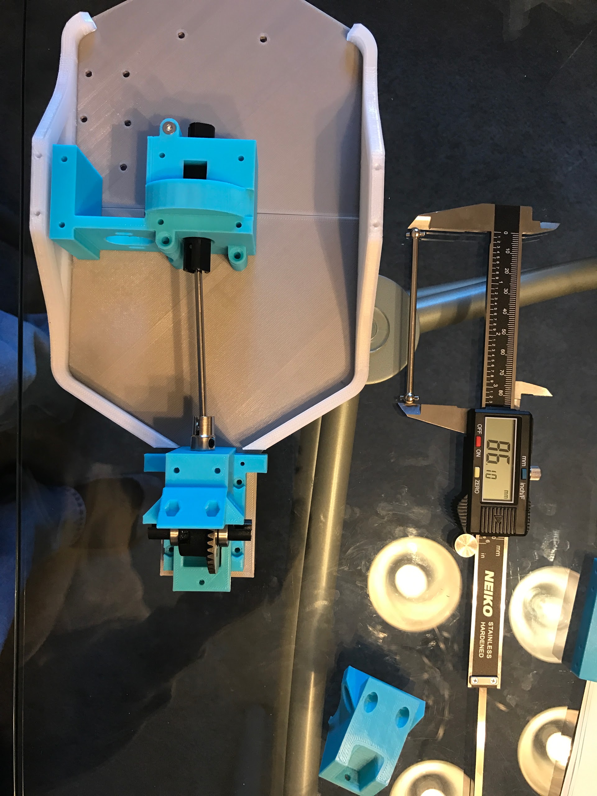

Running into my first issue with the all metal parts from eBay. The dog bones or one of the couplings is about 1mm too long. The bottom mounting holes for the back end differential don’t line up.
Ordering new 84mm dogbones from eBay store. For whatever reason the 80mm I originally ordered are actually 87mm.

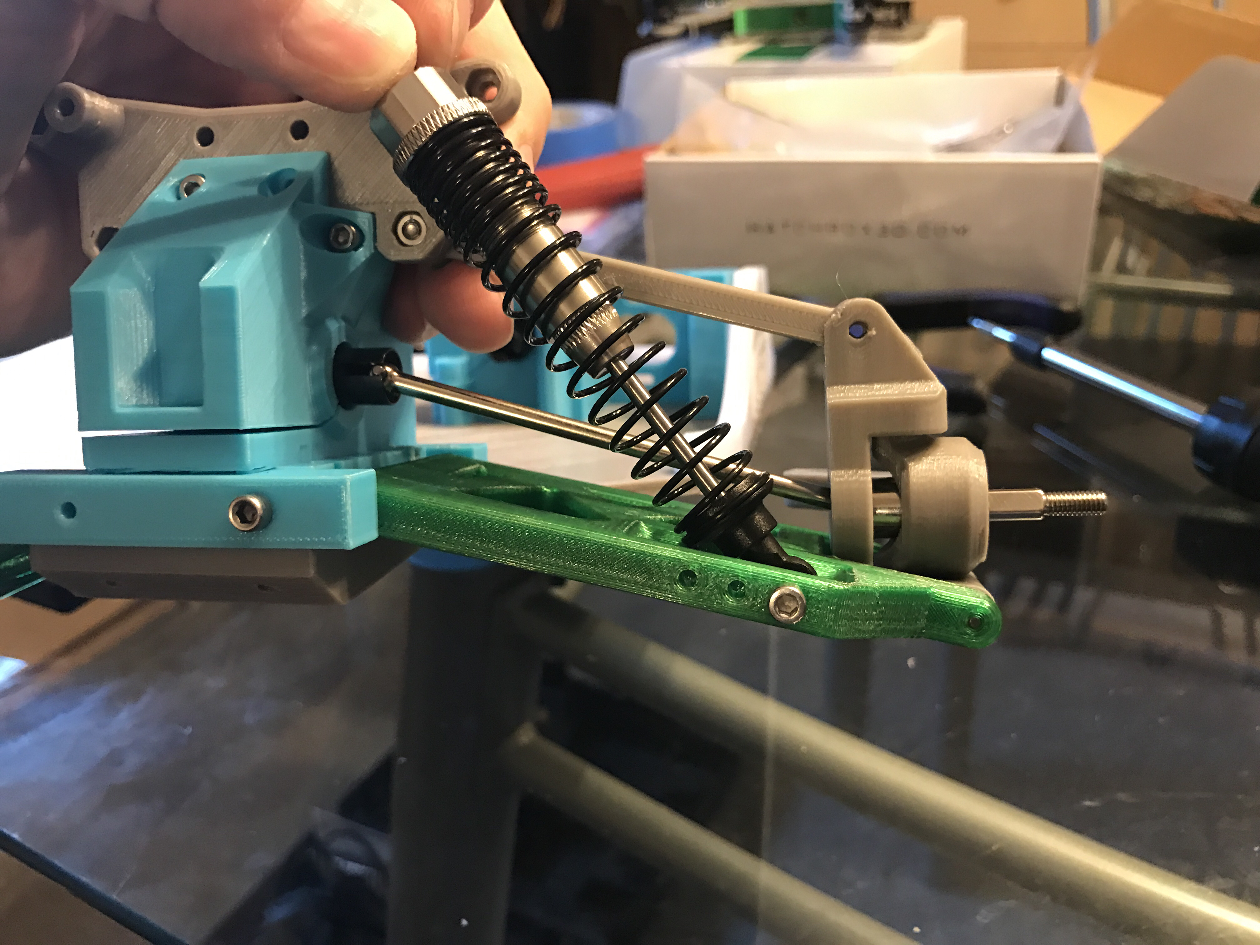

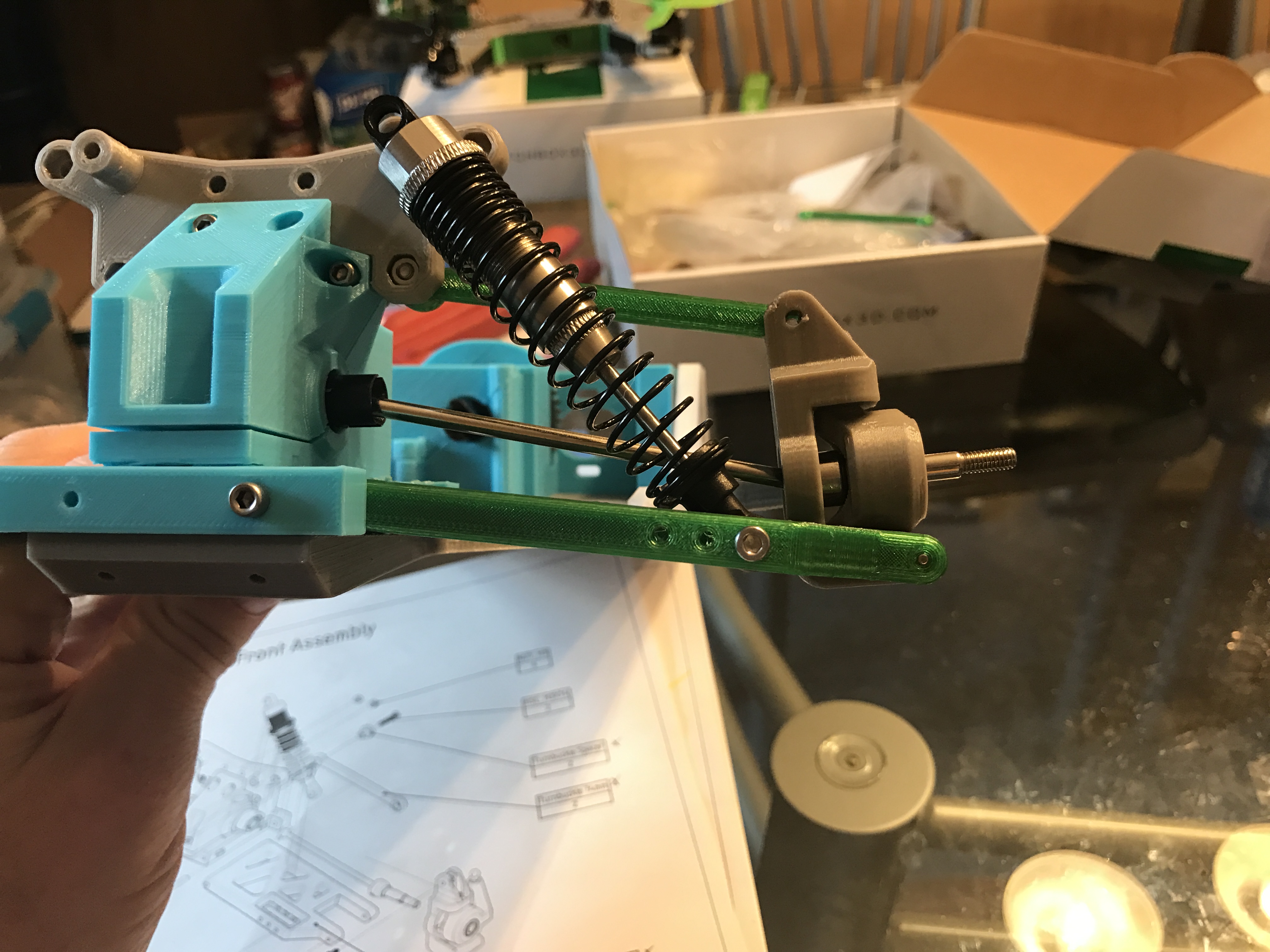

Me again just talking to myself (since it seems no one else in here is alive). Mocking up the front end with the CVC joints from eBay store. Custom 70mm turnbuckle is a little too short (pic one) and the stock 74 is a little long (feels like dogbone may pop out). Guess I’ll have to custom create a 72mm.
Found two other wishbones which are a bit shorter than the stock ones, going to give those a go. zzz…

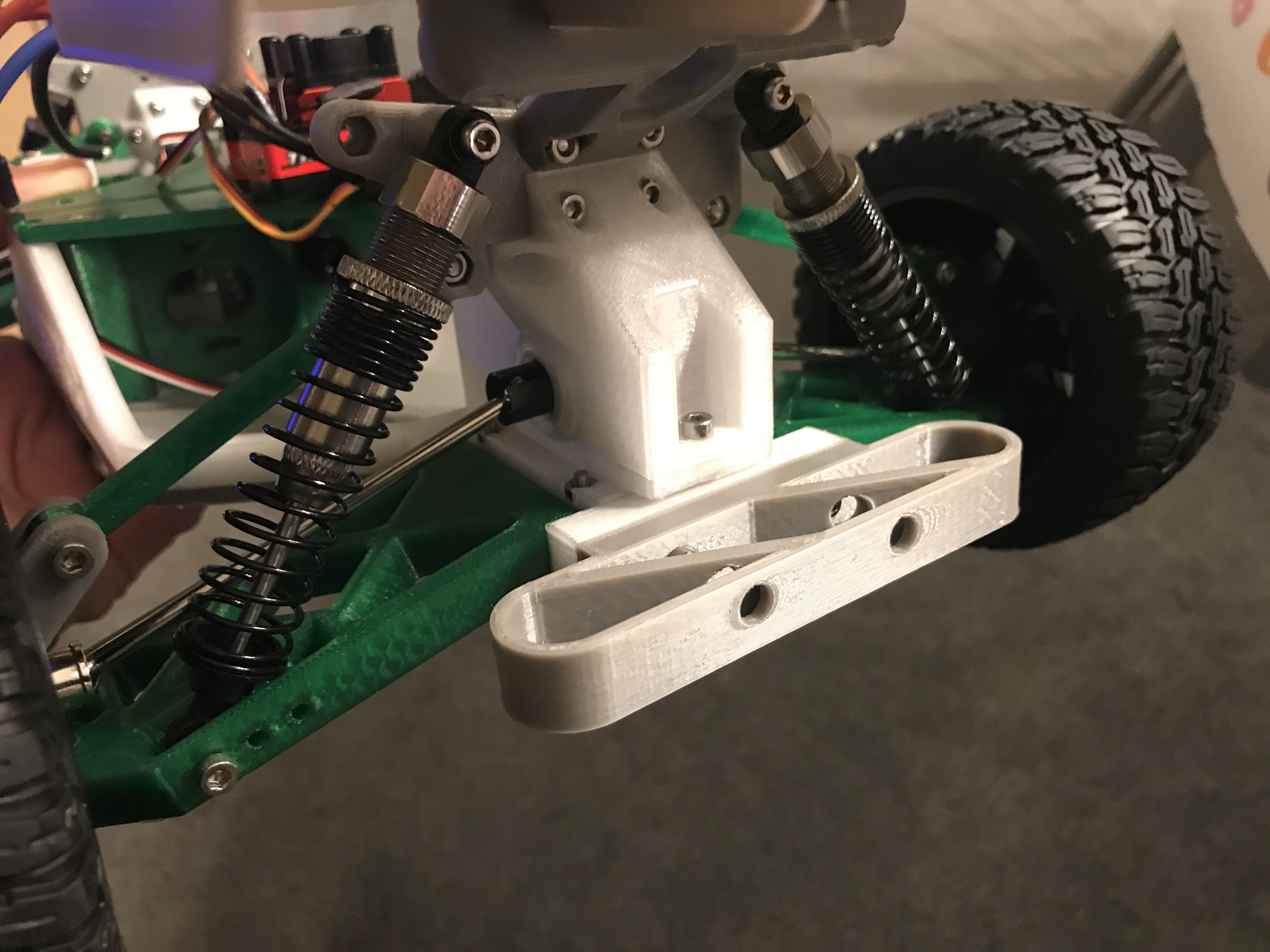

This weekend I printed out the “production” front wishbones and new front differential casing. Just need to install everything and the front should be good. Also tested the “D” adapter hubs and some tires from a traxxas truck I have, they should all work. Will post some more pix and progress soon.
Got most of the front end finished in PETg. Still need to find some spacer for the top of the shocks.

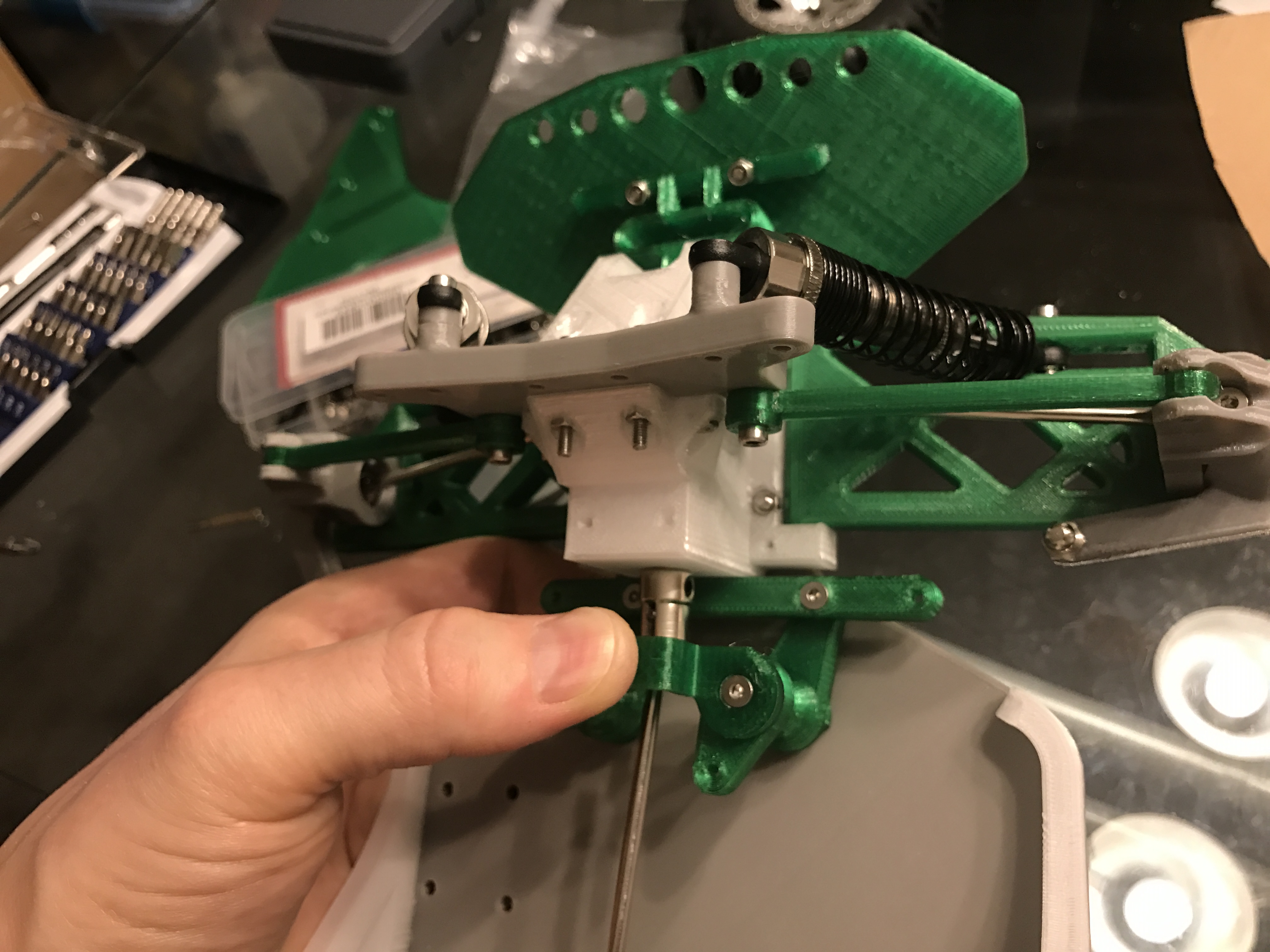

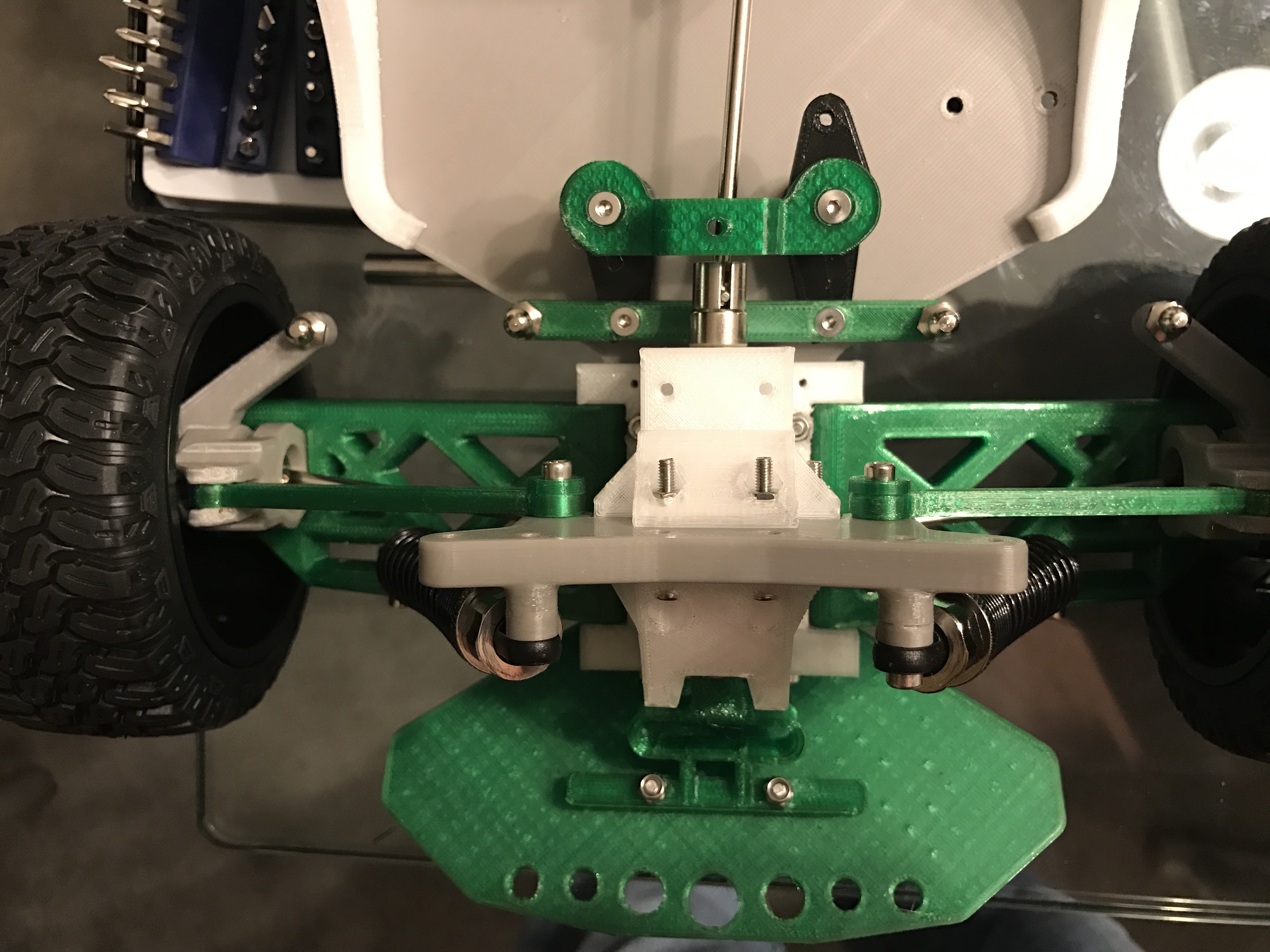

Having some more issues. The stock steering assembly is running into the front differential casing. Also I can’t secure the steering assembly from the bottom as the pivot shafts just spin. Hmmmm
@Kevin_Wojcik you could try attaching the steering rods directly to the lever. Actually that wouldn’t work. It looks like the hole in the chassis is too close to the diff casing. Maybe you could just drill new holes a few mm further from the diff.
@Nate_T It is off just a few mm, i’m not sure I could drill holes far enough away from the existing ones to get a solid connection. @Aron_Horst was going to look to see if he could find the shorter steering arms he remixed. If they don’t exist anywhere, I’ll give an attempt at modeling some. tnx guys!
Tinkercad to the rescue. Imported the parts and nipped off the tips and moved the holes back 2-3mm. Seems to be clearing the differential case now. Also discovered PETG steering parts were very weak, reprinted in PLA. Electronics now on order.

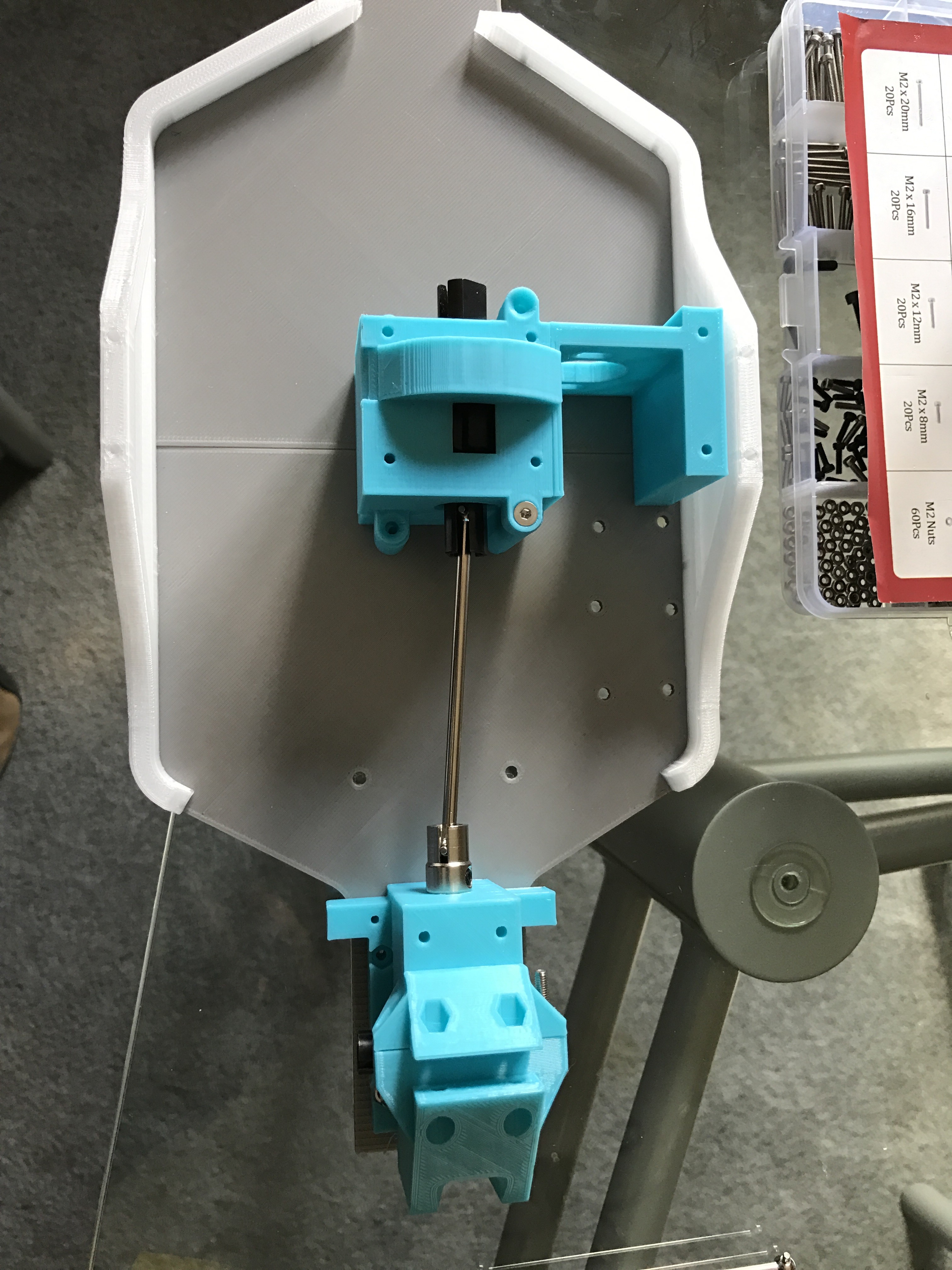

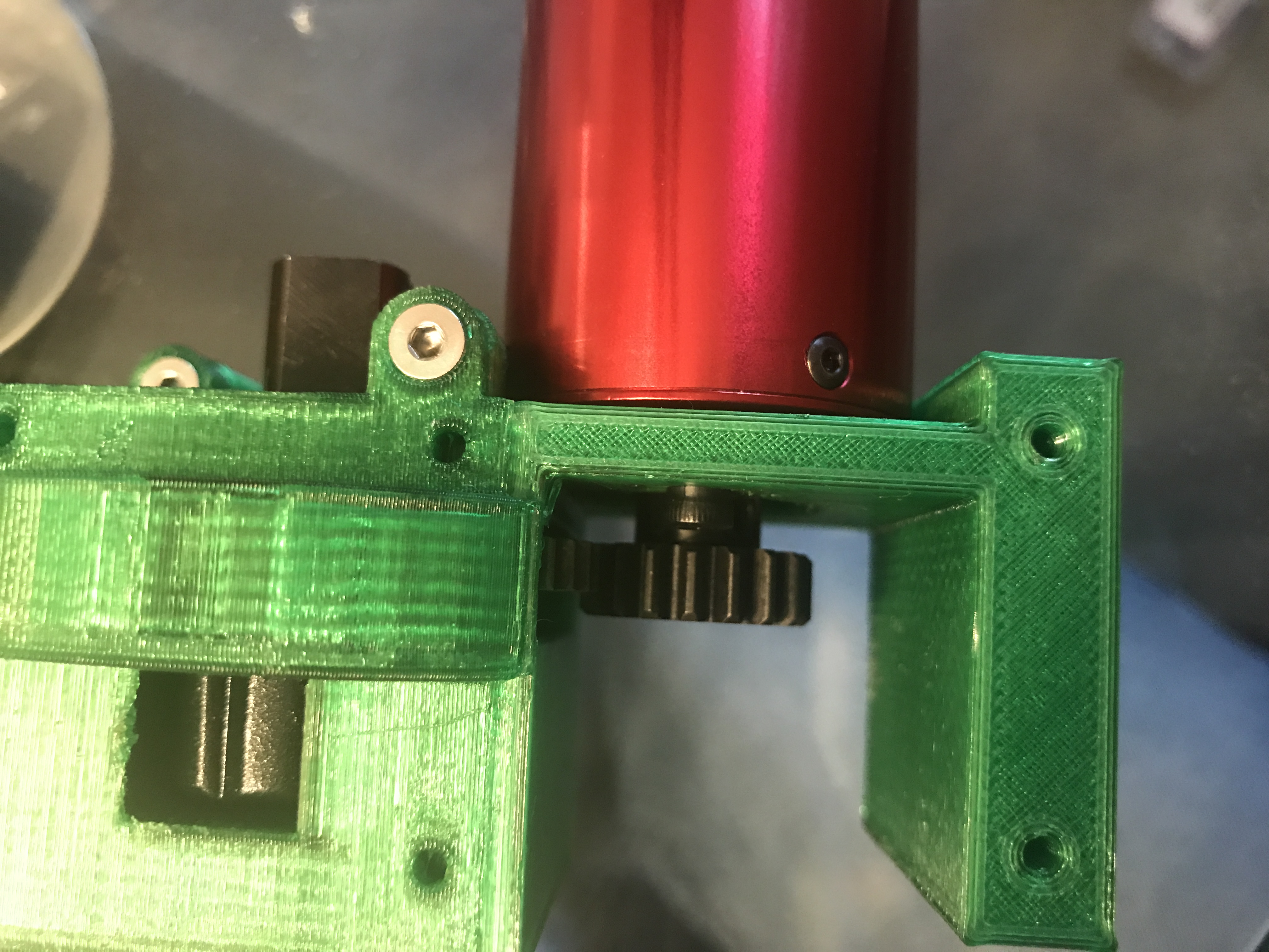

Got the MOD 1 gear and 5mm to 3mm sleeve in. Wow the clearance is very small. Had to actually install the gear through the motor mount. Everything barely fits. Still need a couple washers before I can close it up. Should all work though.

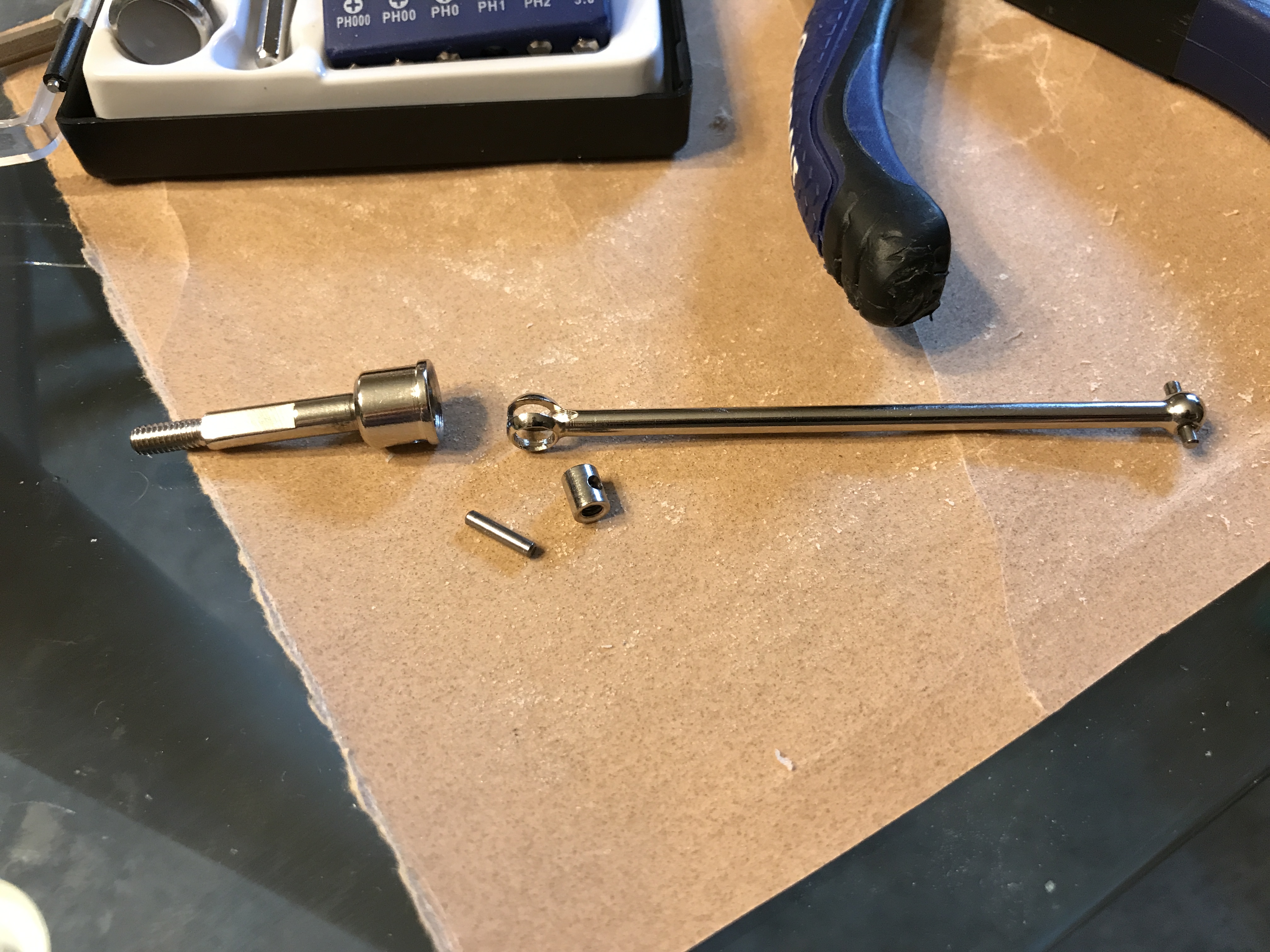

Ok so the motor is working but the CV joints I got are less than stellar. Driving around my living room one of them decided to explode.
Ordered new CV from BangGood but they are too large. There goes another $20 down the drain
have to place another order to Hobbyking and try another set. Sigh… this is so painful!
Just to close this thread out. The CV was fine. Just needed a new grub screw. Finally had the car put all together and took it out this afternoon for part of a battery. It works! Surely room for some tweaks but happy overall. Thanks Daniel!
