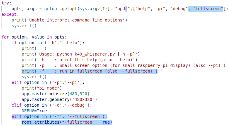

Adding an -f (or --fullscreen) switch only requires a few small changes in k40_whisperer.py (all changed/added lines are highlighted):
