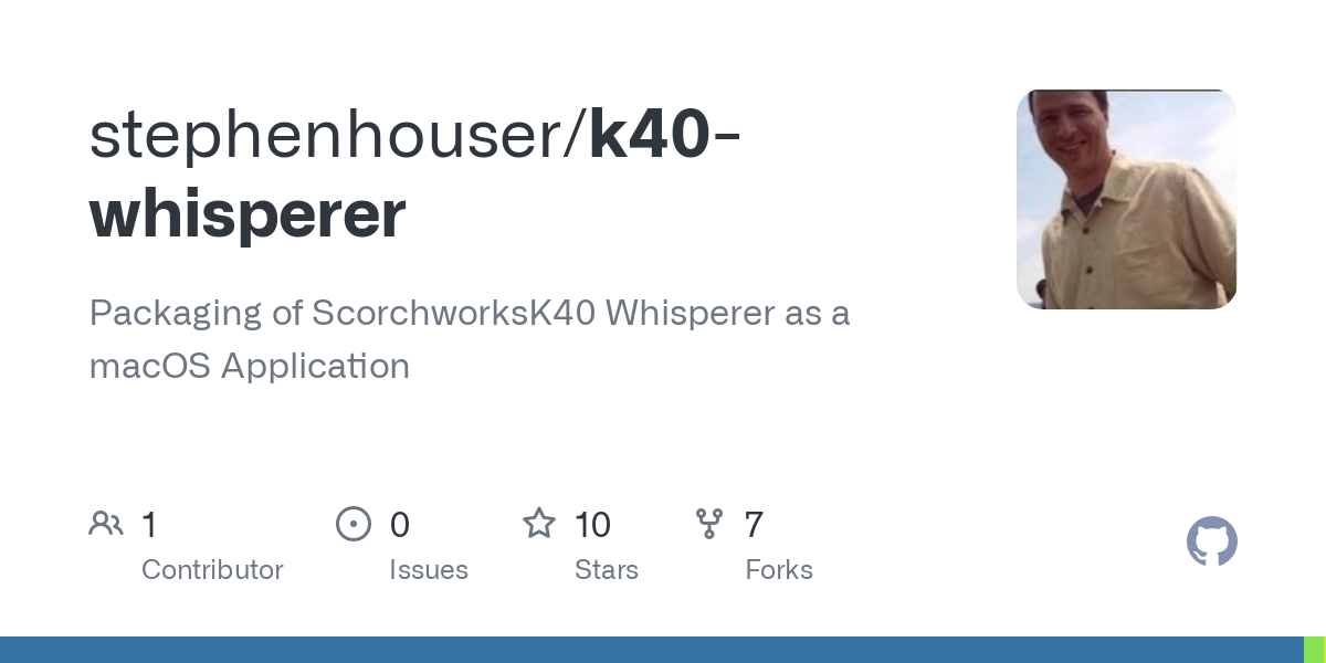

You may also want to try this:
It’s a bit command-line oriented… but looks reasonably easy to follow if you can handle that.
  • Disclaimer; I am neither a Mac, nor a K40-whisperer user…
Good find Owen! Hopefully there is someone here with a MacOS M1 who can try and verify this works and provide feedback to the maintainer( create a git issue report ) if something fails. As long as the latest packages of the 3 needed(see below) are installed, they have native/M1 support, then K40 Whisperer it should work. I looked up all 3 and it’s stated native Apple silicon is supported.
The 3 packages/commands needed to run K40 Whisperer on MacOS M1 are:
brew install libusb
brew cask install xquartz
brew cask install inkscape
