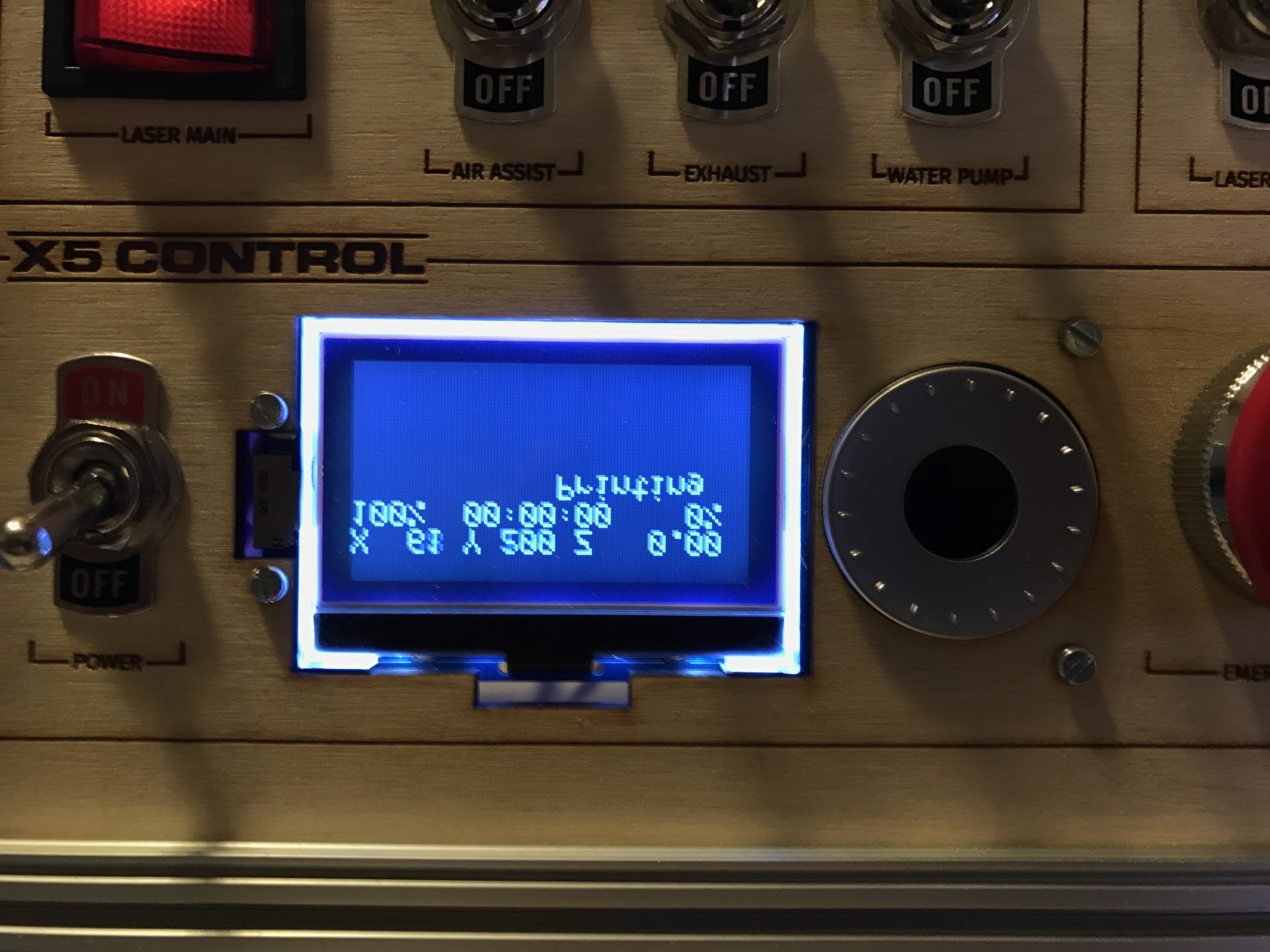

Running my laser makes my LCD do weird things. Sometimes I just blanks out.
Running my laser makes my LCD do weird things. Sometimes I just blanks out. Today it did this.
And now it’s blanked out.
