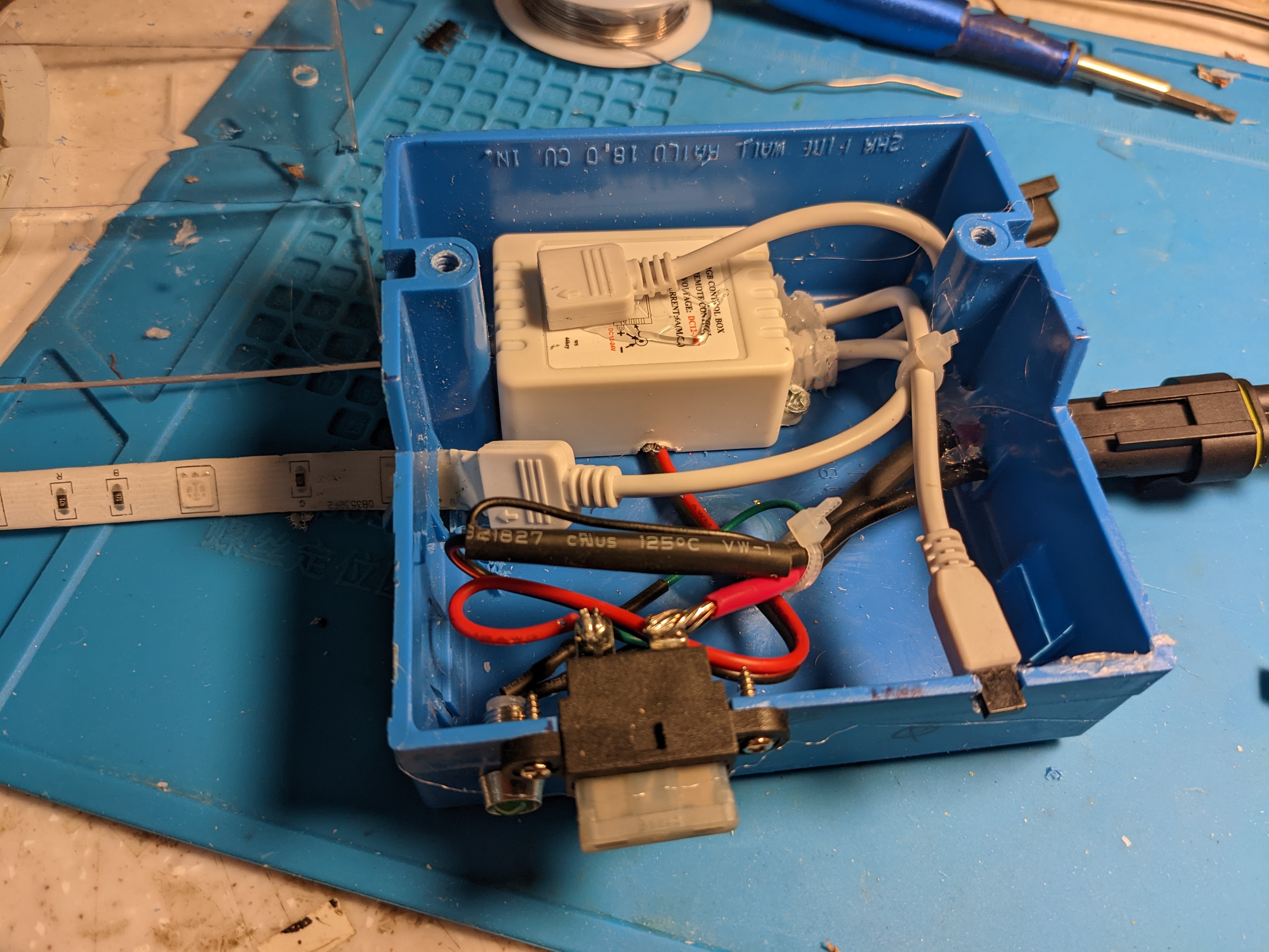

I could have 3D printed a custom case but I went the switch box approach. You can find many styles of plastic electrical boxes that can be used for projects like this. In this case I uses a switch box that has a side box area intended to accommodate expanded wiring.
I bent a form fit acrylic cover. The controllers power plug was hacked to allow the use of a Weather Pack waterproof power connecter. The IR sensor is positioned in a notch and held in place by the cover. A blade fuse was added. The LED strip plug exits the box in a position that facilities mounting the strip on the RV frame. All the cable exits were sealed with silicone. I would call the box water resistant not waterproof.
