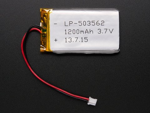

At the moment/was planning on using CR2032 coin cell batteries to power the whole thing. I have one of these 2xCR2032 coin cell battery holders (https://www.adafruit.com/products/783). Although I’m not sure this power solution will be sufficient. The 144/m neopixels seemed like a great idea, but with 50 pixels (even with a max brightness of 25%-50%) and the huzzah…not sure I’m gonna have enough juice?
50 x 3 x 20mA = 3000mA at max. 25-50% of 3000mA = 750 - 1500mA
If you want to run it for an hour you need something between 750 and 1500mAh
A CR2032 has a standard max current of 0.2mA and 210 mAh (page 6)
A CR3032 has 6mA / 500mAh
The answer is simply NOPE.
You have to go for something like this:
If you use a Feather Huzzah then the charger and FTDI is already included :wink:
I also heatshrink this guy just leaving the USB connector accessable.
