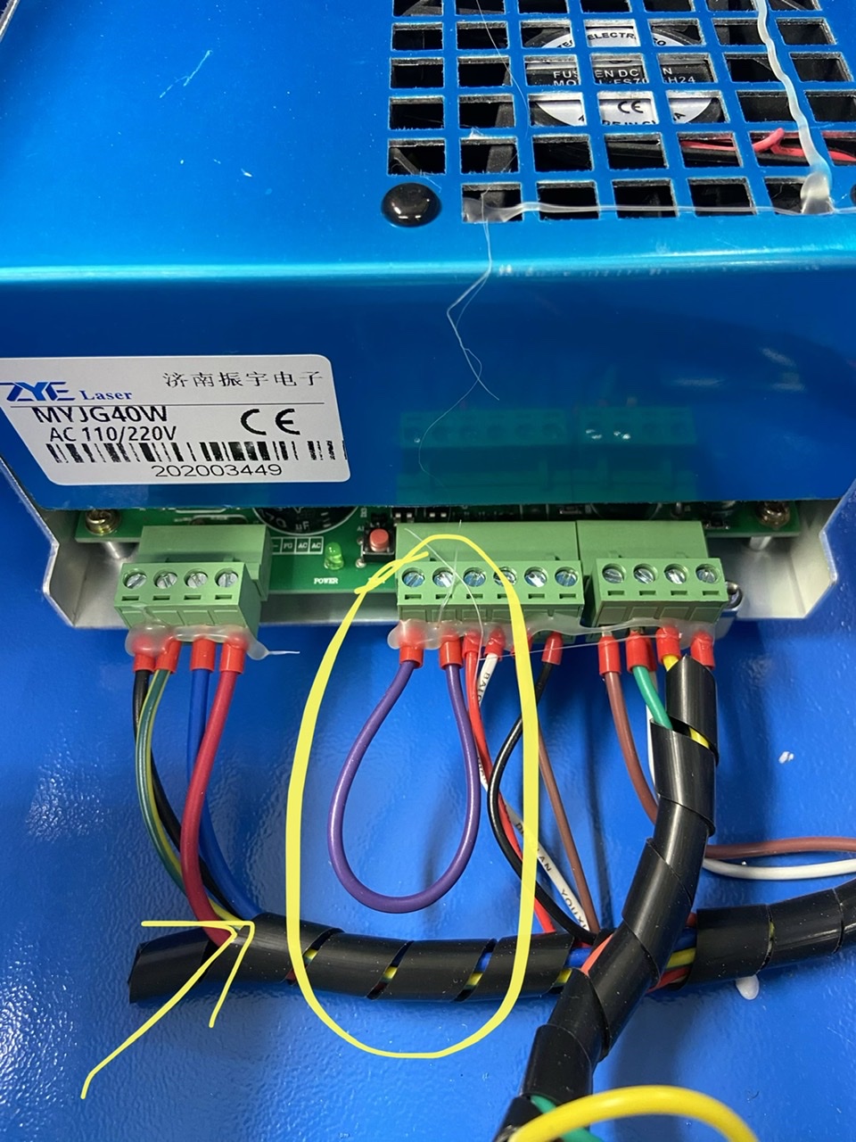

I just received my K40 and have been digesting information while I wait med for my Cohesion3D board to arrive. I have one door cutoff switch and will be getting two more, and hopefully a water flow sensor soon.
Am I correct in thinking that I can cut this wire circled in yellow and install the switches between them?
Yes, that is the circuit you want them on.
Congratulations you are one of the few K40 users that take safety seriously!
Add switches in this circuit for the front and back covers and your water temperature and flow sensors. Your machine will be safe and free from major failure…
