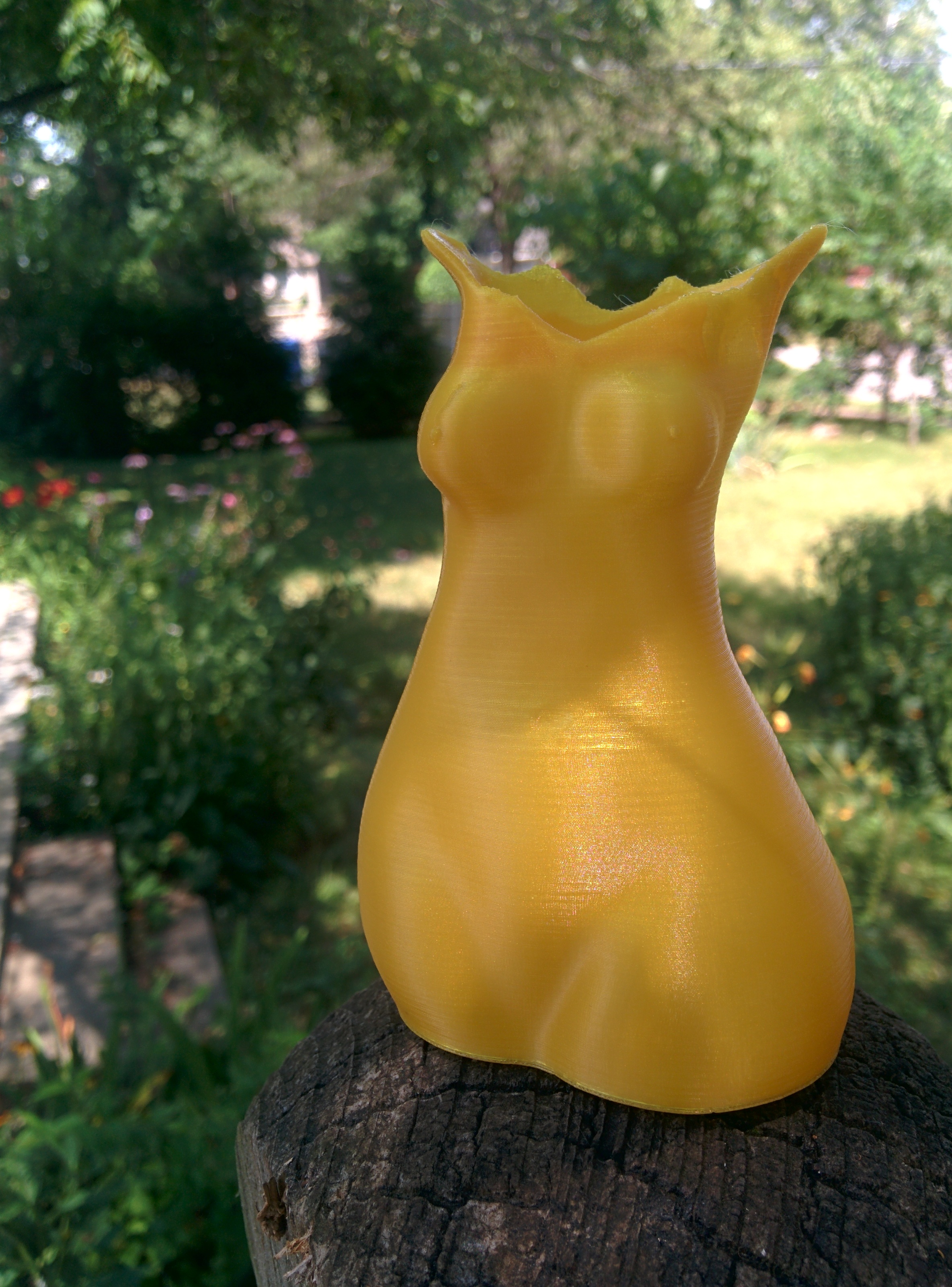

Samantha Jean Moore approached me about 3D scanning this awesome sculpture she made.
Samantha Jean Moore approached me about 3D scanning this awesome sculpture she made. The kinect did a great job when coupled with Artec’s software.
I don’t have my scanning rig ready so this was also manually done by moving around the object. Also, I blended two gcodes to make the print hollow as this scan doesn’t include the interior shell. At the neckline, I swapped for gcode with 6 perimeters which you can see leaves a few loose strands as opposed to a complete interior failure.
wonderful job, and a really great sculpture.
Kinect classic or the new one?
Kinect classic, can’t wait to get a hold of the newest one.
