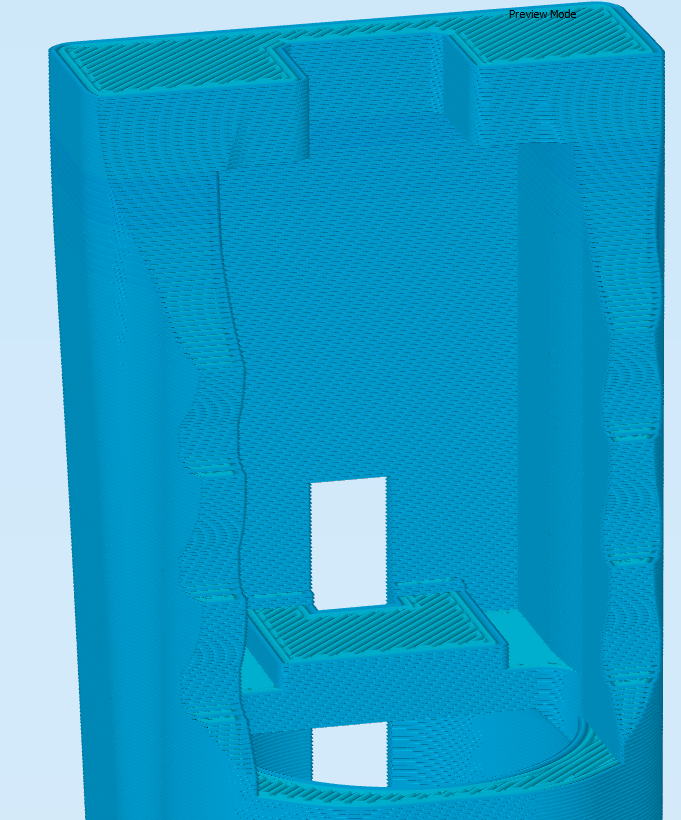

Same file, same pattern, is my z axis bad ? Or is it termistor? Speed is the same. Two shells. Should I go slower? There is small shift of to one side when model have something uncommon like hole or end of the top surface -but then the shift disappears and then it comes back . Any ideas ?

Looks like a backlash type issue. You’ll often see temporary shifting like this at geometry changes.

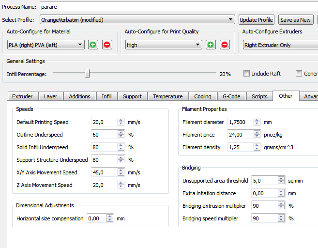

Could be some binding of some kind. Are your bearings well lubricated? Slower print speeds can often eliminate the shifting you are seeing. What speed are you printing at?
It’s definitely not a problem with the z-axis, what orientation was your print done in?

@Jeff_Parish 20mm per second per second, so quite slow but it have too heads so it is heavier -I have to keep it slow as possible. The lubrication - I use teflon all weather bicycle oil to keep the moisture out. heh. uk.
@Ryan_Carlyle okay I heard Thomas Sanladerer saying something about backlash, but he did not mention how to get rid of it l; is it managable in Simplify 3d maybe >? or adjustable mechanically?
@Duncan_Gunn what do you mean orientation ? the designed orientation of course XD thicker base lower thickness to the top , all perfect very easy to print, except for this weird artefact, I am fitting PCB inside so I have to file that down a little , in 8 units.

i`ve had this exact same problem appear a few times with a new x drive train, only to disappear without any trace.
it looks exactly like backlash should look, but none of the tests i could find come back positive (including the one above - which prints perfect).
