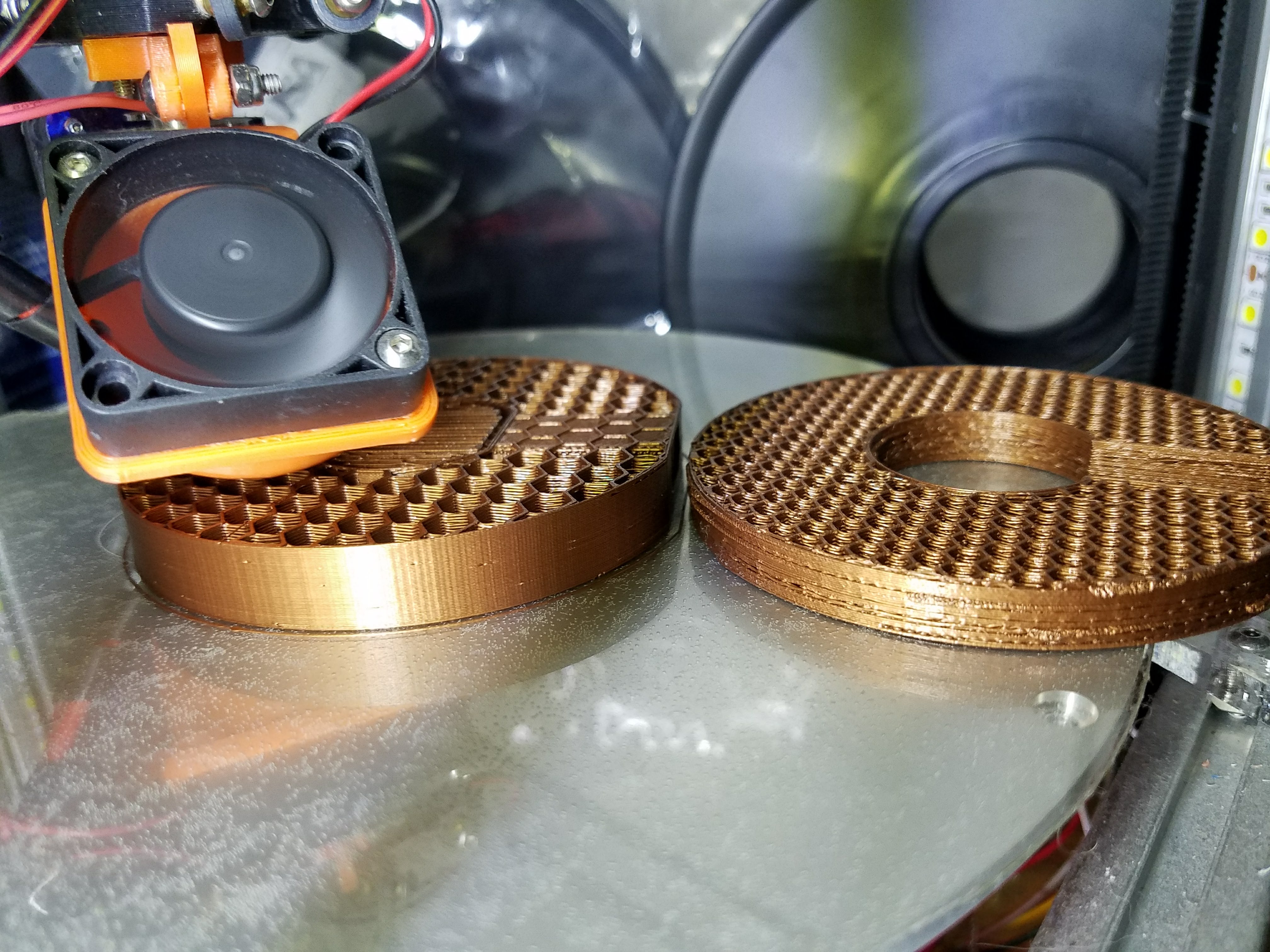

Same print (still in process), two days, two attempts.
Same print (still in process), two days, two attempts. The only differences:
40% infill vs 20% (40 seemed unnecessary)
Drying the filament overnight in a sealed bag of Silica Gel
Cleaning the nozzle with the hot-pull method
Looks as though the 40% needed bed height adjustment?
I didn’t touch the bed height between prints. I suspect what you’re looking at is just the fact that I tossed the 40% (after removal) next to the 20% still in process. The first layer on both was perfect.
@John_Roth it definitely shows a good representation of 20 vs 40 infill.
Have you tried cubic infill? It’s much less jerky than honeycomb.

Maybe I’m being obtuse, but I don’t see the failure on the 20% infill version. Did it fail to adhere to the bed?
@Ross_Bagley No, the 20% printed perfectly. Only posting both for comparison. And I could be wrong, but I don’t think the difference in infill was a factor in the quality.
@Ryan_Carlyle You think that maybe only the outer filament on the spool had absorption?
@Ross_Bagley Yes
