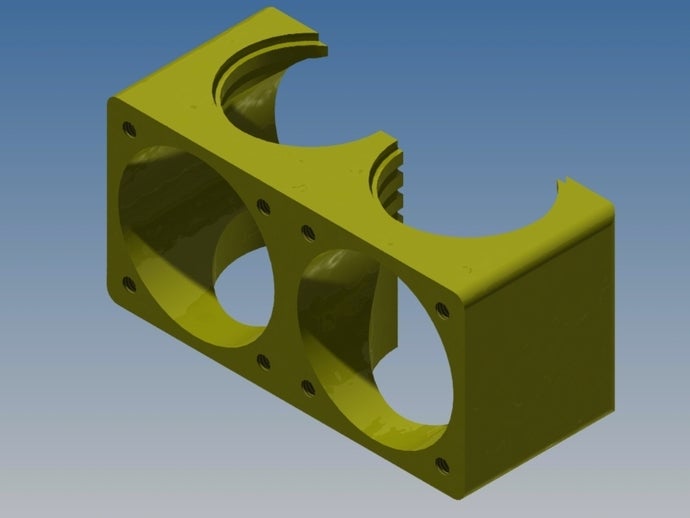

That is awesome Stefano - you must be very pleased. Your clamping approach looks very similar to mine, especially the way the Bowden press fit connectors are mounted on the top plate - is the plate tapped or do you have a retaining nut for the fitting underneath? I am totally using your fan mount if you stick it on Thingiverse
Thank you very much Tim, the top plate is tapped and also if the alluminum are quite thin there is no too much force exerted on the press fit so it is good. I uploaded this morning the fan mount; i had doublechecked all the dimension, but in case you have problem or suggestion give me advice
Looks good! I assume the ridges you’ve put on the inside to prevent the mount from moving up and down the heatsink? My E3D provided mount is a little melted because of that
Thanks for posting the inventor file too!
I have just started to put together a dual nozzle head for the Ultimaker. Have you measured the temperature close to the top of the aluminium part? Thanks.
@Tim_Rastall Yes, I copy the philosopy of the orginal mount that have some round ridges; I make them a little more sharp, but hope not to be too tight with tolerances to mount onto the heads. @Paulo_Geraldes I do not measure it, but I’m able to take the head in my hand from the groove mount part also with the hot end at 300 degrees; the E3D guys had made an amazing job to maintain the cold end really cold… I have not so much experience with different hotends, but the last I use is a J-Head and the Peek part become quite hot during printing while this is almost ambient temperature.
@Stefano_Pavanello that is probably under 50deg C that is kind of what I was hoping. Great, thanks.
Keep up the good work. I will be posting some of my stuff later.
