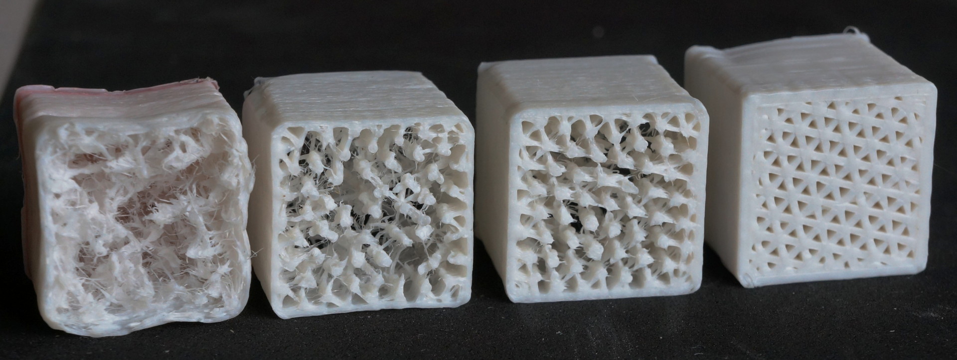

Intentionally using underextrusion to soften structure. The cubes have a 65% gradual Triangel infill and printed in Flex with a flowrate of <30, 30,45,100.
While the right Cube(100) is very stiff like a brick the others are soft as the Infill parts are not interconnected and can move free while still acting as a support for the Walls and Top. (Prints are without top and bottom layer) The left one is like a sponge. The outerwall is printed very slow so the negativ effect of underextrusion is reduced while the infill was printed fast.
