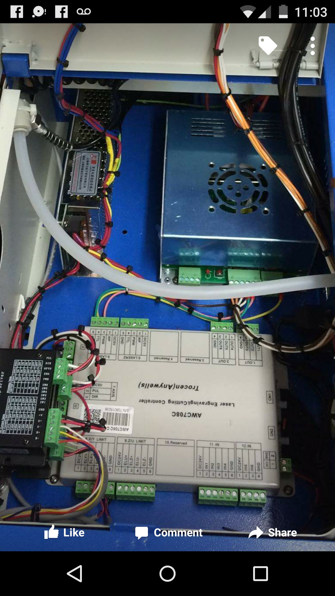

Saw this DSP upgrade on Facebook looks as if they are TTL on In and pwm to the Pot connection… maybe useful for figuring out the best way to wire up a smoothie conversion
+Peter van der Walt @donkjr @Arthur_Wolf …

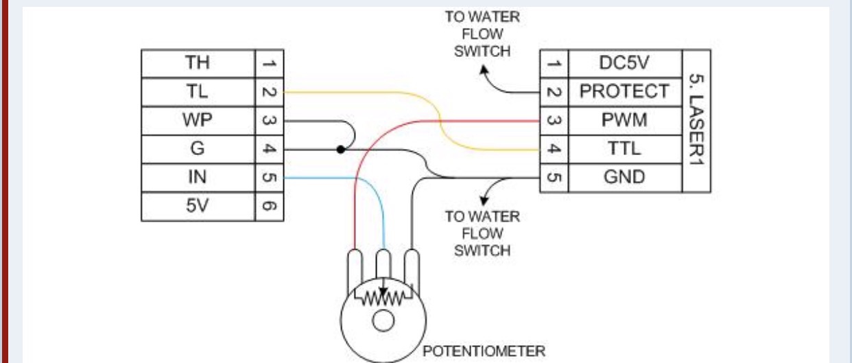

Thanks, part of my research was to understand how LO interfaces their controller to the LPS. They have connection diagrams on their support site:
Interestingly they do it two ways:
In one case they ignore the L and use only the TH and IN even though all three are present. I think in some supplies TL and L may be connected internally. In the one I have been tracing L is connected to the enable signal usually used for enable and interlocks.
In the other case they use IN and L like above.
The most relevant learning from this is that this works with no level shifter which makes sense cause the LO DSP’s don’t provide 3V outputs.
My big aha this week was that folks are taking the PWM signal from the boards internal PWM not through a FET :), which is why a level shifter is employed.

@K1111 my answer to “why to pins” would be that with a two pin configuration you have control of:
- The supply’s output with one pin (in this case TL) independent of any other control.
- The supply’s power level with the PWM dependent on #1. (however in the case you show above the power level is the product of the pot and the external PWM)
So if you want a control that overrides everything you can control enable (TL) to the smoothie as a separate signal. BTW not all supplies have TL, TH.
If the smoothie only asserts its PWM when it expects the laser to be on then #1 is theoretically not necessary.
However, If you wanted more control independent of the controllers PWM then asserting #1 at the start and end of a job would provide added overriding control of the lasers output?
To my thinking the “Laser Switch” provides enough external override for safety.
