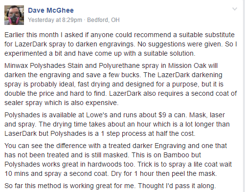

Saw this on facebook today. Looks like an interesting idea. Sometimes get into pieces of plywood that don’t laser very dark and this might be a nice thing to try.

I had that same question about the op on Facebook. Light coats over transfer paper I’m assuming but I worry about the solvents bleeding through.
