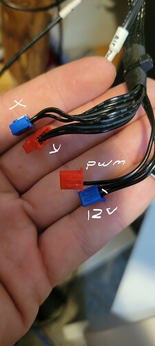

Long story short, I had to buy a new board for my s9. I ended up getting the MKS Gen L 2.1 Ive hooked it up from what i can find in other forums and Facebook groups but not only is it still not working the 2 pin red connector that has the single wire coming from the laser has no place to hook up. I apologize for how silly this may seem to anyone else but any help would be much appreciated!

Can you describe where each cable originates & what function it provides? I.E. what does the other end of these cables look like?
What functions are working and not working?
What firmware/Software are you using to drive the new board?
Guessing at the wiring.
12VDC:
PWM:

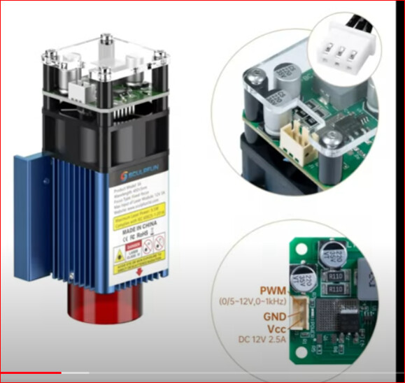

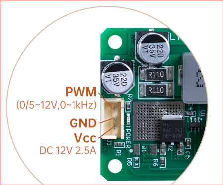

The specs on this look strange: I don’t know if this means Low = 0, High = 5-12V .
Is the wiring functions shown below correct?
Post pictures of the laser head showing views of all its markings.
Does your head look like this?
Got these hints this video.
