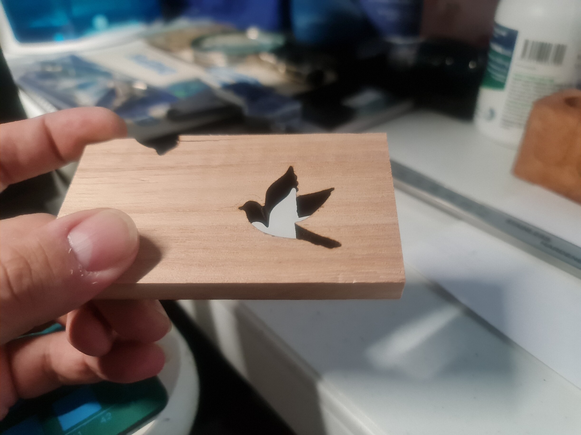

I’ve got one of these S9’s. It’s my first laser engraver/cutter so i can’t compare it to others, but it does what it says it will. I just literally ran a 15mm test piece of wood through it. It needs 100% and about at least 6 passes, but it does it without air assist.
It does what it says it will. Cuts 15mm solid wood. 100% at 6+ passes. Works with Lightburn and LaserGRBL.
thanks @genepatton, good to know.
how many mm/s in 6 passes?
15mm in 6 passes, all without air assist. Solid wood not mdf or balsa.
MMmmmm its hard to argue with that pictures results :slight_smile:

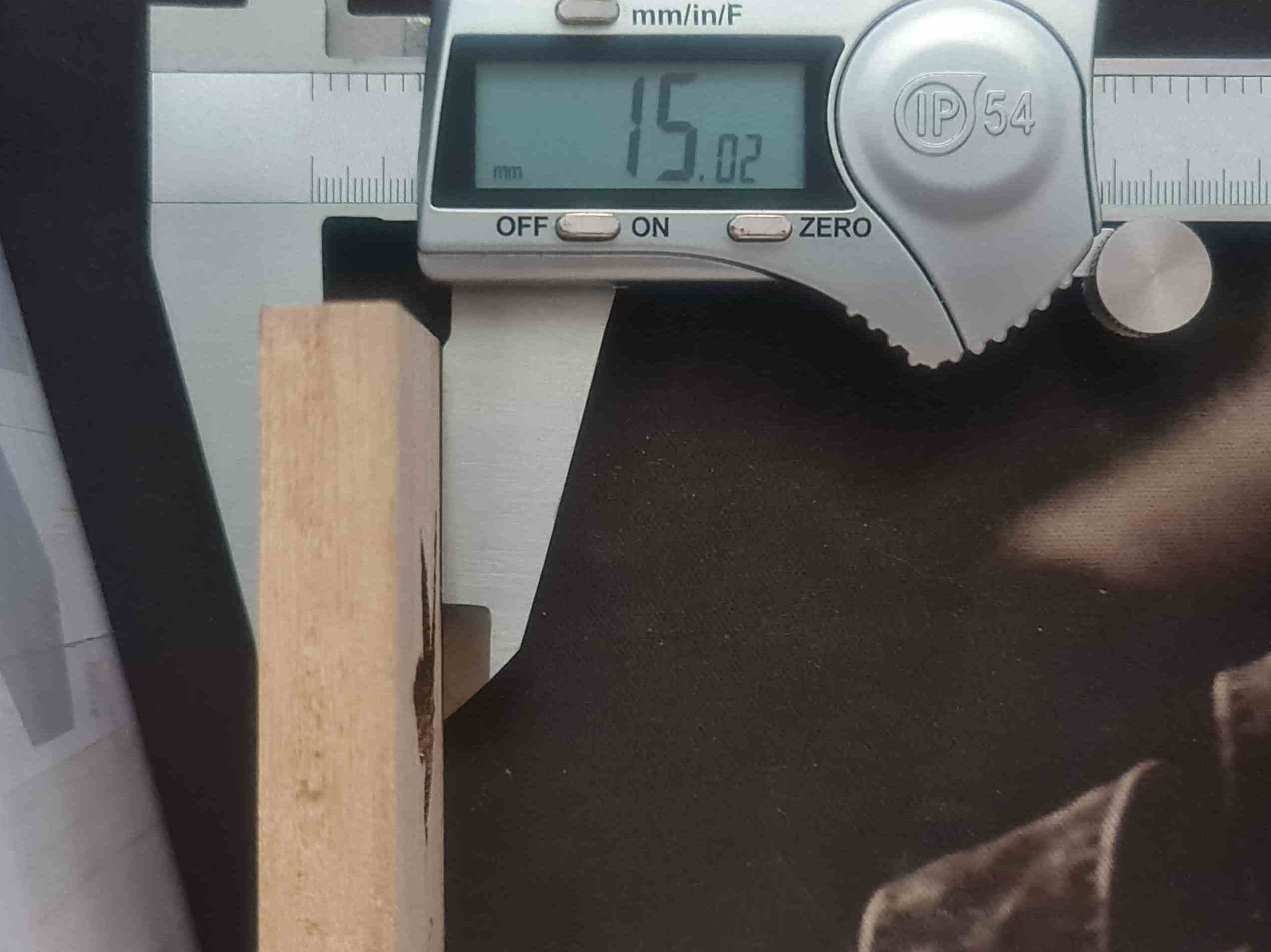

I’m sorry, but if that wood is 15mm thick, you mut be a giant. Please post a pictrue with a caliper.
I’ve got big feet too if you’re wondering :kissing_smiling_eyes:
I think it was 300/400 mm/min
I was thinking if that wood is 15 mm you must have a huge micrometer!
Sorry, couldn’t resist…

May I ask what type of solid wood?
