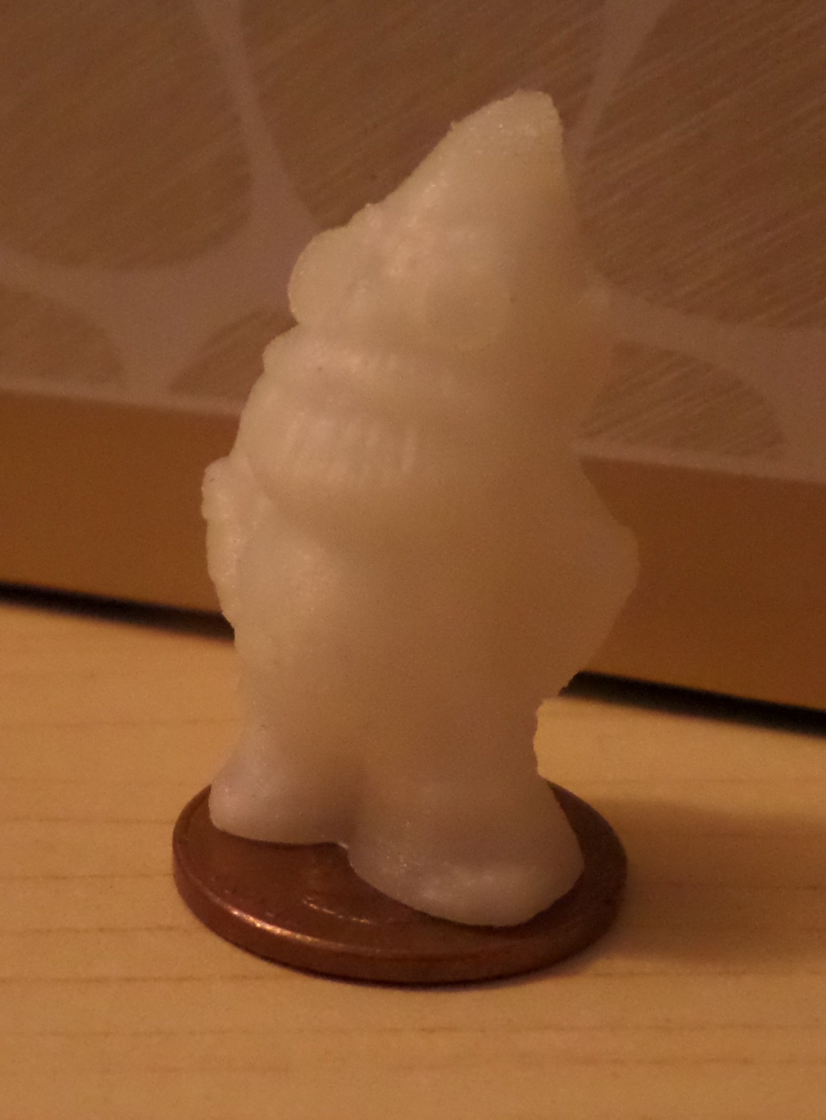

Second test print with new nozzle. Size is 0.2mm tip with 0.06mm layer height.
Second test print with new nozzle. Size is 0.2mm tip with 0.06mm layer height. Filament is Hatchbox Glow in the Dark. Really hard to get a picture that shows the detail, but most of it is there and fairly well defined. ^^
That looks good but I hope your using a hardend nozzle. Glow in the dark filament is very abrasive!
@david_merten Haha, I didn’t know that. Guess I’ll be getting one soon :stuck_out_tongue:
@Mindless I believe it was 15 or 20 mm/s. Layer height was 0.06mm.
