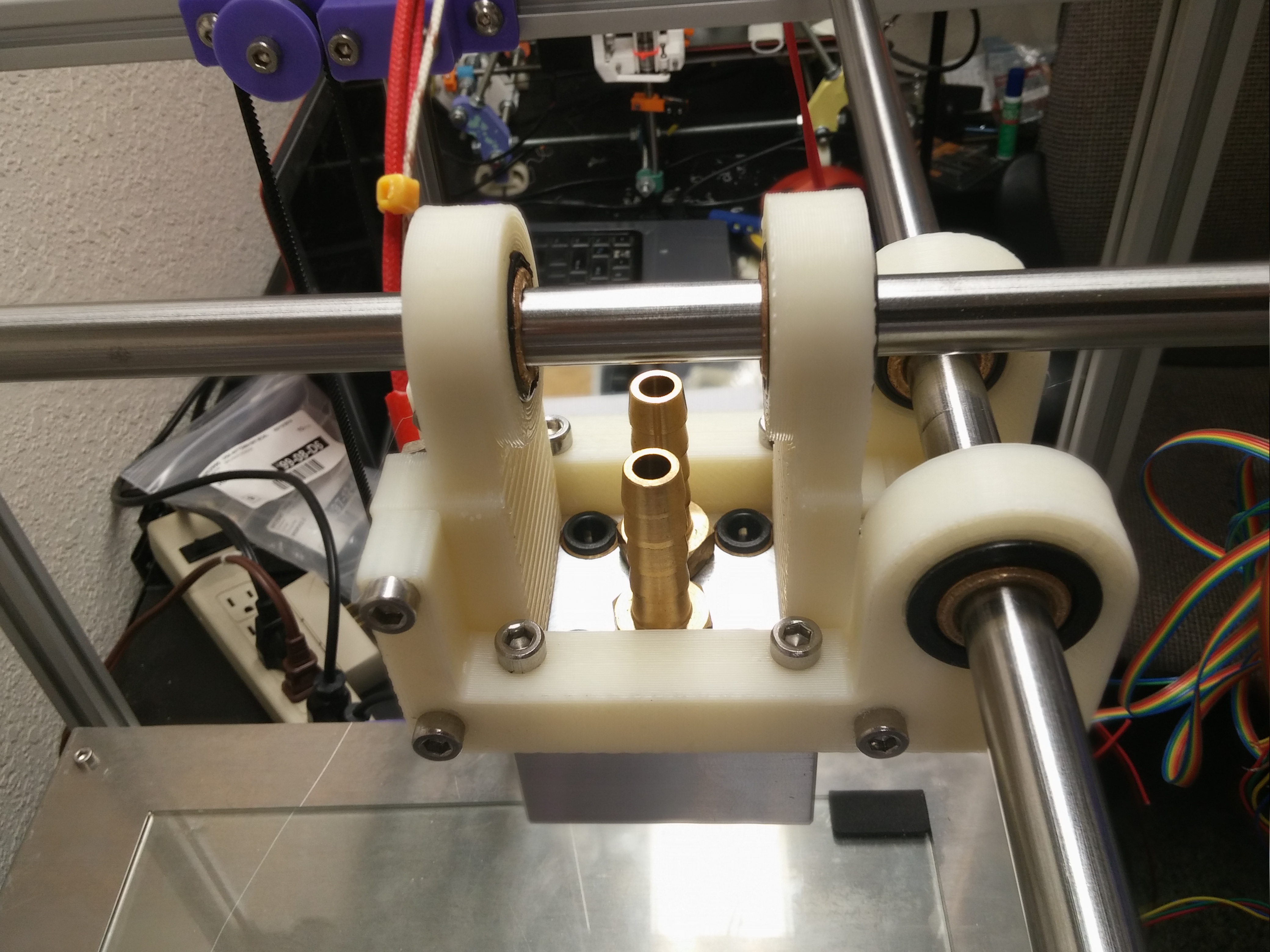

Second version of the carriage for the Kraken. Centered on the rods better and this one will let the Kraken actually touch the build surface. These prints were sliced with CraftWare software. CraftWare lets you modify support similar to Simplify3D.
Your part came out much better then the melty tower or garbage I’ve done in craftware. Guess I should look more haha.
It took a little bit of testing to get the settings where I liked them. Support works great.
You going to see rub of the cooling lines on the smooth rod?
Yes. I will print up something to help with that.
@Sonex128 you could also look at angled barb fittings. Something like this: http://www.amazonsupply.com/anderson-metals-brass-fitting-degree/dp/B0070TV4B8
