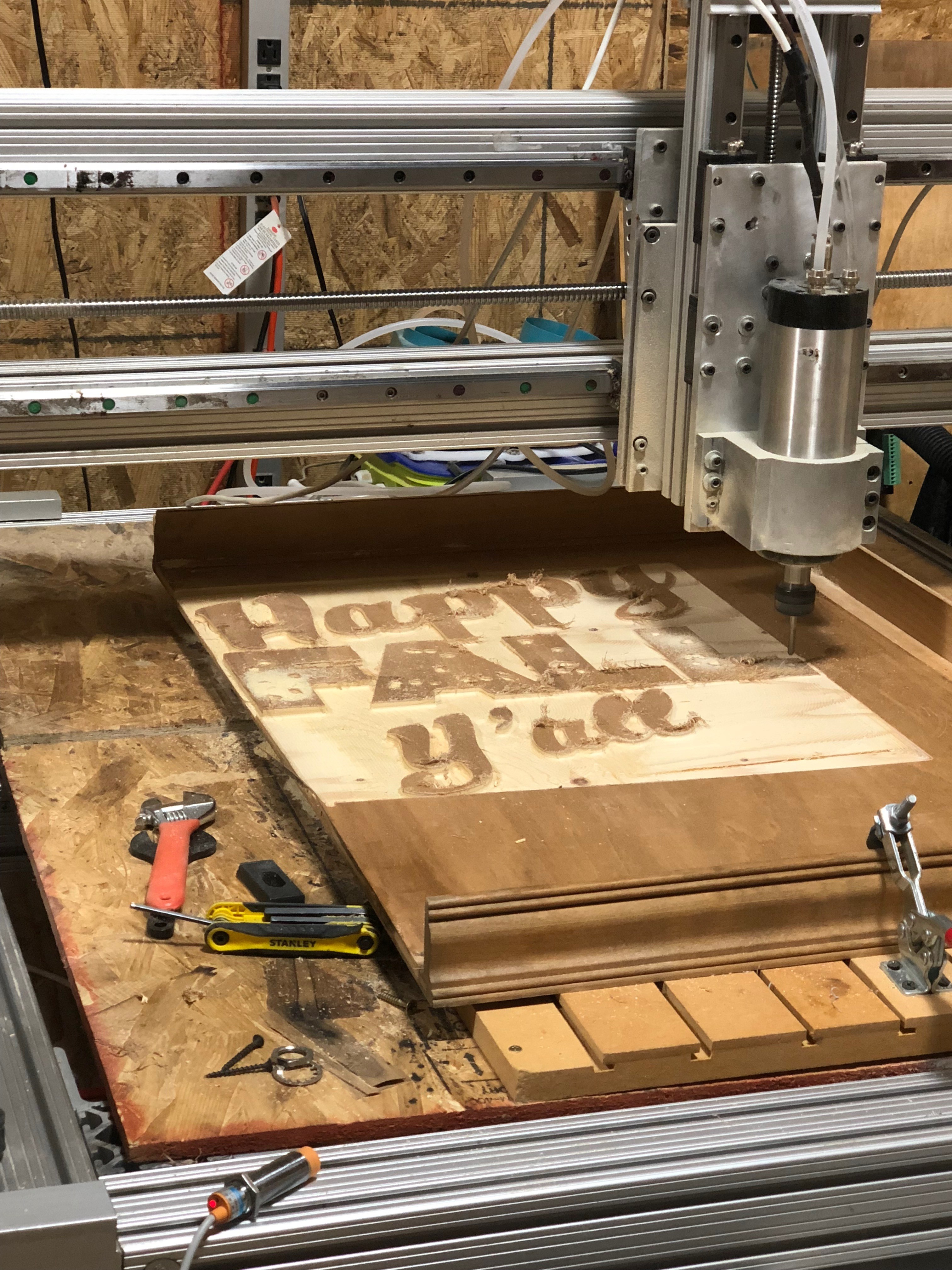

Seems to be working!
Patience pays off!
What speeds, feeds doc and woc are you using what tool?
@Paul_Shaw Everything is still kind of experimental, but I think I was cutting at about 12K rpm. Feed was slow, but I don’t know what it was. I used a 1/4” ballnose bit. Everything went fine (except the bit was too big for some of the detail. At the end I experienced some more of that binding.

It wasn’t binding, I discovered. The flexible coupler on one of my table motors broke.
