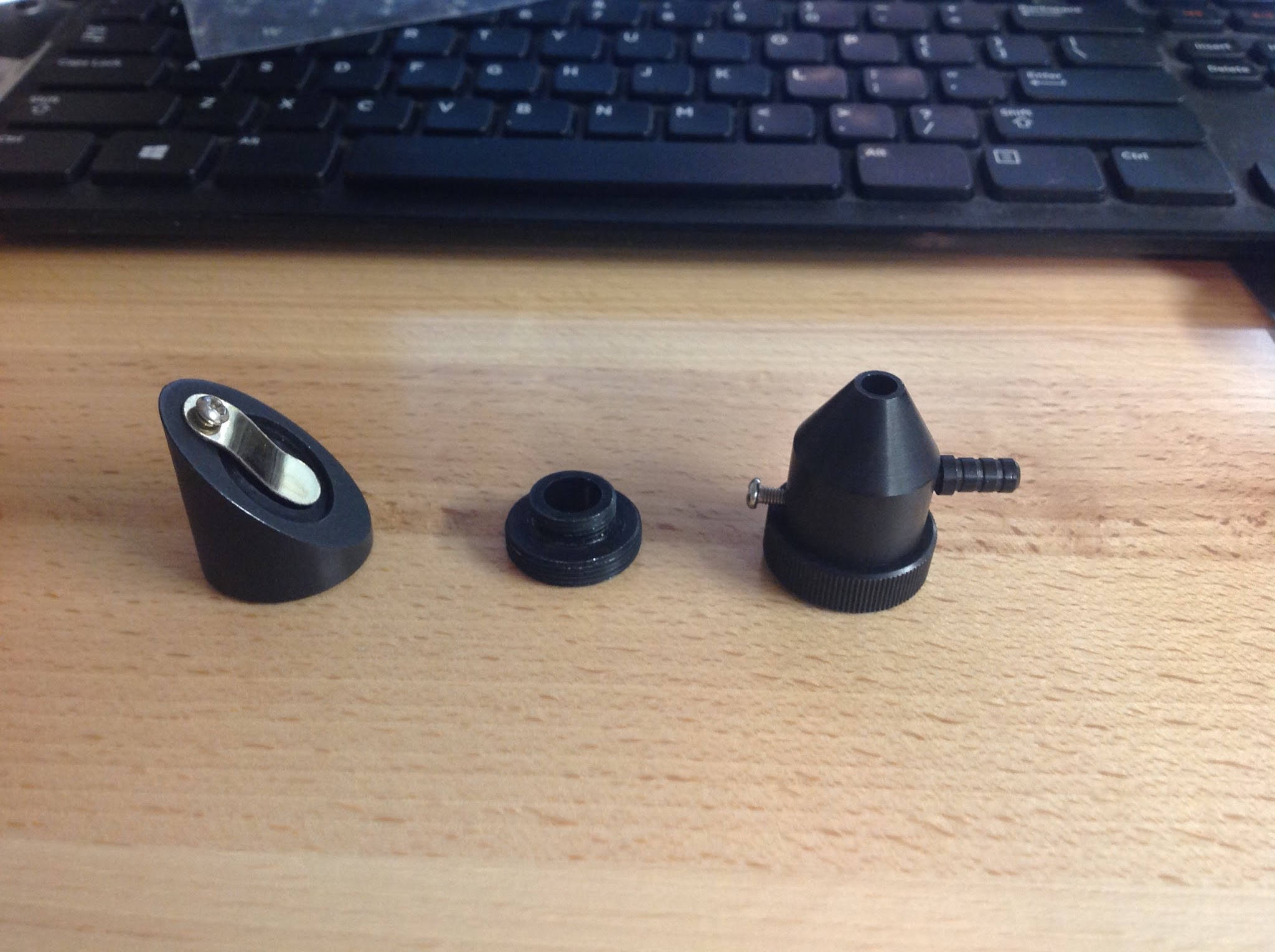

Seen this come up several times. So thought I would post a pic. The threaded part screws out of both pieces.
The air inlet is also threaded into the cone, check once in a while to make sure it is not going to fall out of the cone
