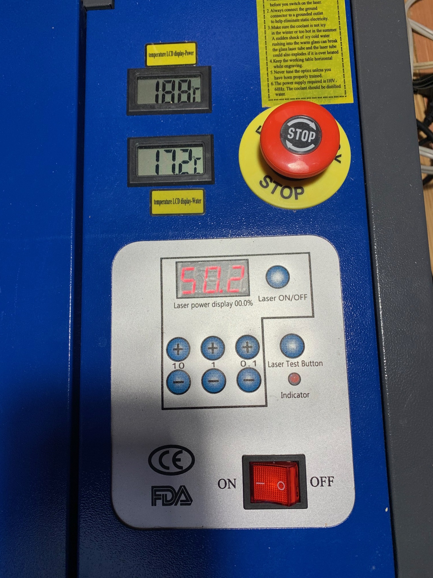

The meter I am talking about is a laser current meter which came on the machine or was installed as an upgrade. This meter is in series with the lasers cathode and measures its current.
Post a picture of your control panel.

It hard to tell what your K40’s laser power is doing when there is no MA meter. This is why we recommend installing one. They all used to come with them.
We can also put a DVM in series with the cathode and measure it that way.
