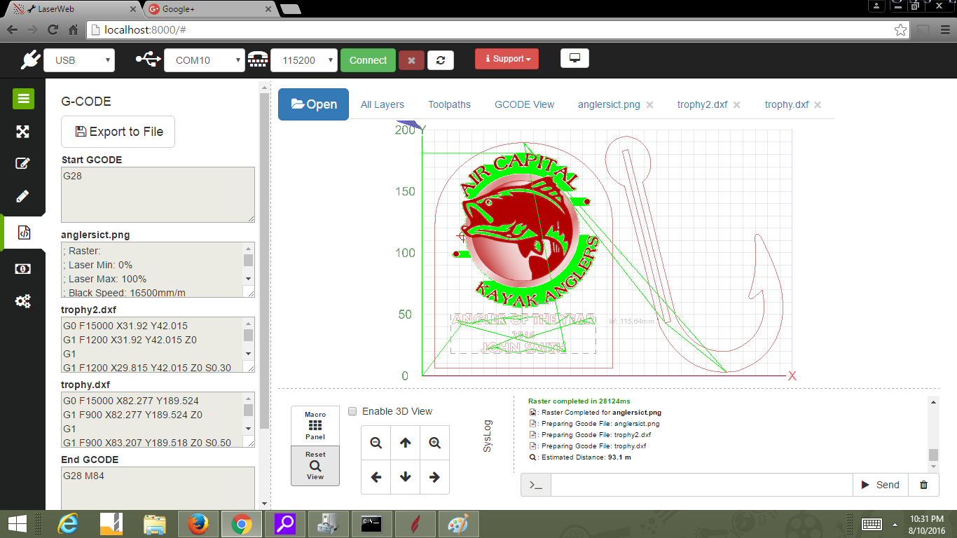

shall we test this out
+Peter van der Walt go big or go home
Do you run directly from sd? I’m using the UI
Lol too late
it’s already running
Can I run a console command Play sd\program.gcode? from laserweb or is all console commands invalid… might make a nice new button to add
“play from sd”
