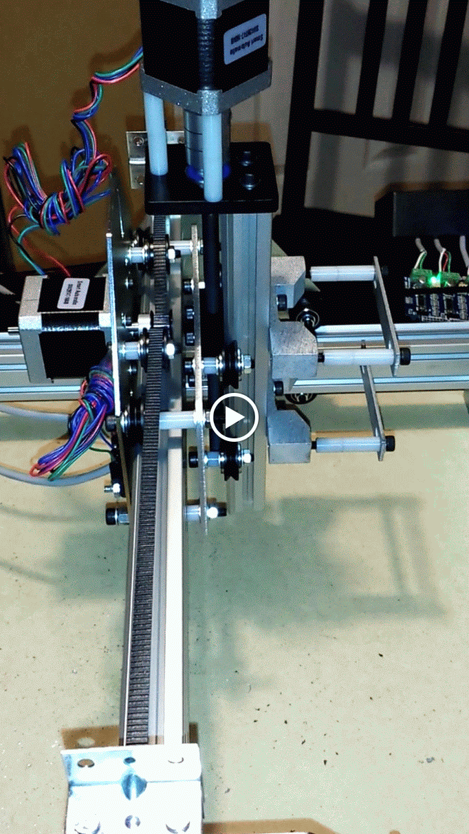

Shapeoko Kit #1956F is alive! It took me and a couple of buddies about 10 hours to put it all together. What a great kit!
Grats! Did you have any problems with the Z axis delrin nut? Mine is very tight and sometimes constricts movement every other turn.
Not that I could see, however, I still need to get everything calibrated. Which I hope to get done this week.
I found that the bearings had a flat side and a bulging side. If you notice any of the V wheels having too much leeway, it’s a good thing to check. My Z axis moves far less now and I get more accurate cuts.
