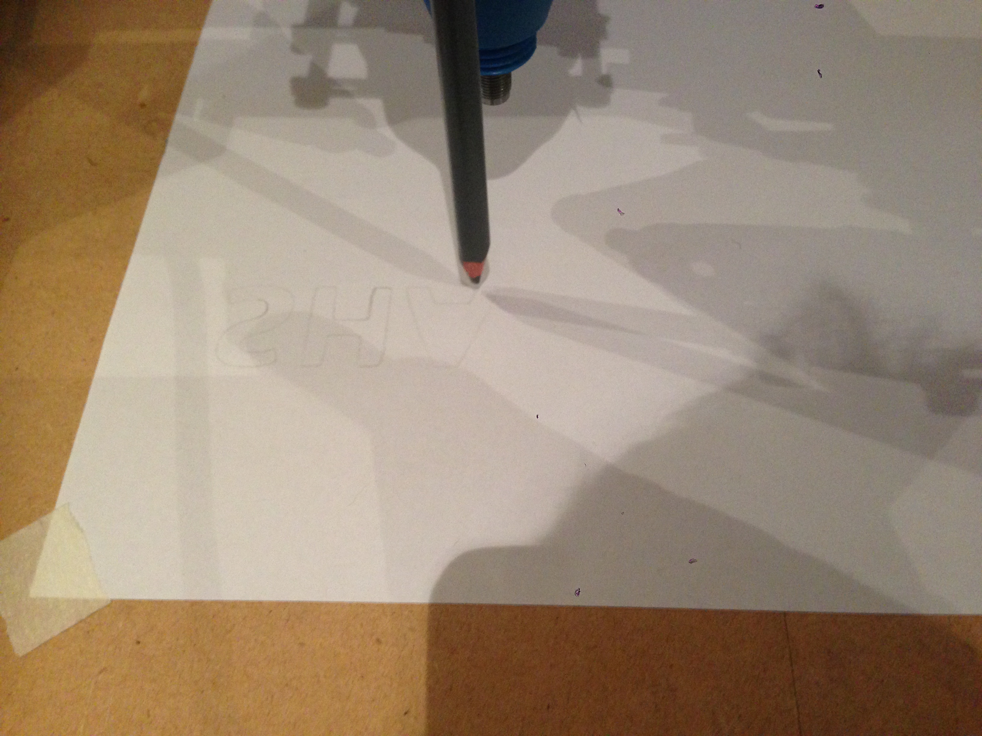

Shapeoko2. First go upside down! Turned the X axis the correct way around
Second go perfect!!!
Very happy

mine wrote backwards the first time… Lol
I have the same issue. How did you fix it?
@Tony_LaNuevo_AdoboTo hey Tony, you need to reverse two wires on the motor, or enter some commands into GRBL or UGS
I turned the x-axis around
You can see as the left y and z carriage have the wires coming out of the top of the motor. The right y carriage the motor wires are to the front.
And when I say turned it around. That is unscrewed it from the y carriages and turned the x axis around so the back now becomes the front. I had mistakenly put it on back to front!!!
