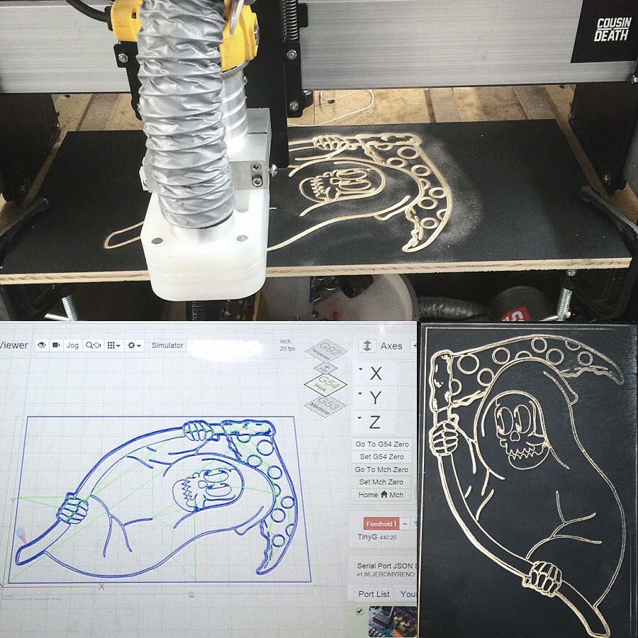

Shapoko 3 tearing up some painted wood last week

@Jeromy_Ainsworth Does the paint help reinforce the fibers of the wood? I’ve been experiencing some chipping in my top layer of ply wood trying to do cuts similar to this
@Alex_Krause – sharp bit, very high rpm, and if you absolutely need a perfect surface try putting tape or a waste board over it.
@John_Bump how thick of a waste board would you recommend?
@John_Bump if I can’t achieve a very high rpm can I reduce feed rate to reduce the “chip load” on my cutter?
Yes, but that does increase the risk of the tool rubbing and burning.
