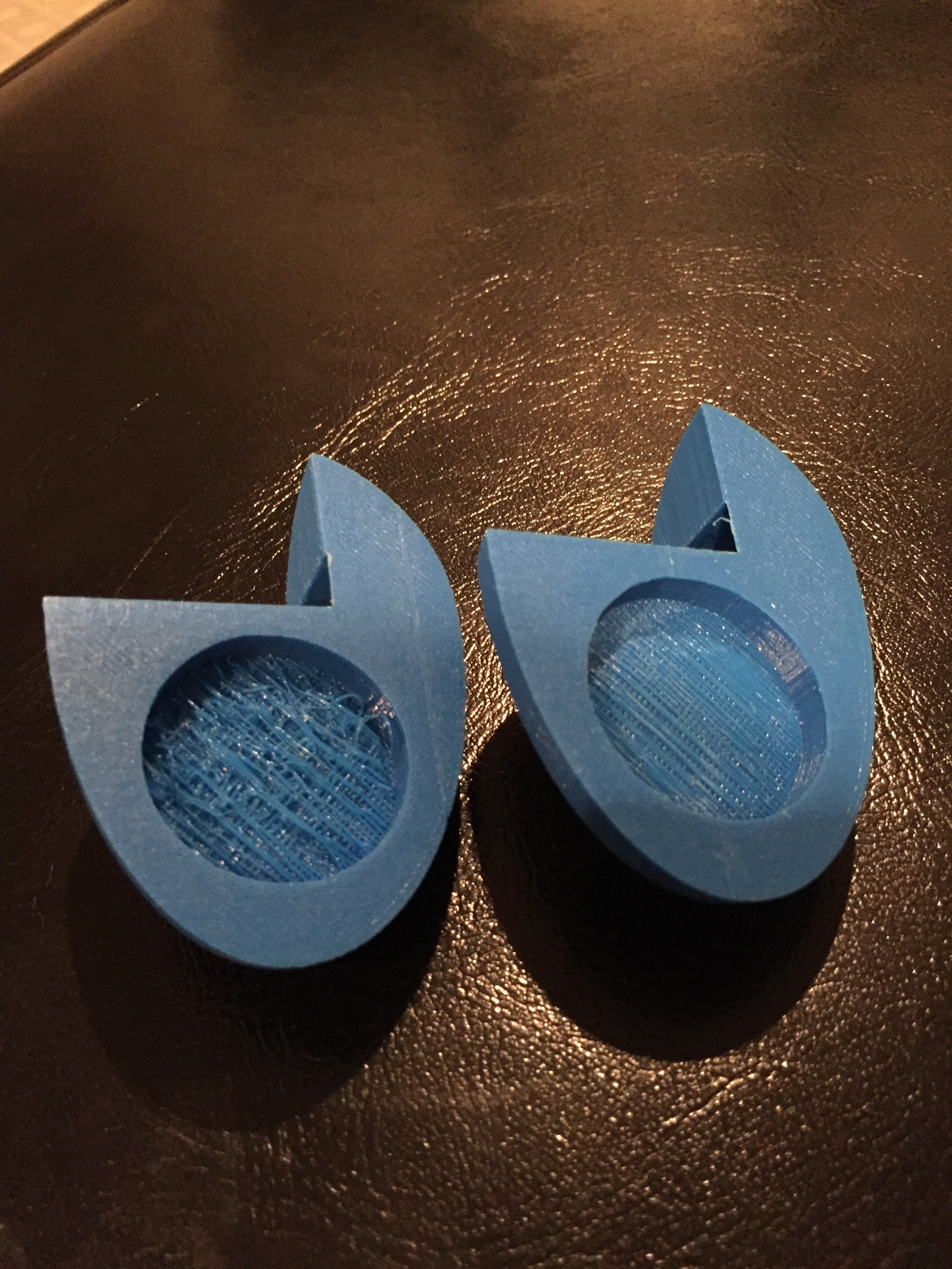

Sharing here as well. What a difference good part cooling can make.
What a difference good part cooling can make. Especially with bridging. The diameter of the hole is 31mm. Left side has no part cooling fan. Right side is 100% cooling fan and the same printing speed as the outer surfaces. This is with PLA. No support material used.
The part cooling fan ducts I used are here: https://www.thingiverse.com/thing:2901039

@Alex_Wiebe No need to orient the print any particular way. The duct design is such that it blows a concentrated stream of air right across the tip of the nozzle horizontally across the top of the print. See the picture below. I can feel the air stream on my hand up to about 10 -12" away. There is very little turbulence from the nozzle tip in the air stream so geometry on the far side of the nozzle cools just about as well as the near side.
It does not affect the hot end maintaining temp at all for me. I get rock steady hot end temps with the fan all the way to 100%.
By using a centrifugal fan that produces a high Cfm and over pressure I can restrict the nozzle opening and direct the air exactly where I want it and not have blow back through the fan. (By comparison cover up more than about 1/3 of the open area of a regular 40mm fan and you get air blowing backwards through it. Really hard to concentrate that on a focused area.) Being in one direction it removes the heat from the vicinity of the part quickly. I also print in 0.1mm layers or 0.05mm layers for precision prints so there is not a lot of mass to cool off.
I will have the fan off for the first layer (0.1 - 0.2mm height) and then at 33% for the second one. 66% for the third layer and 100% for the 4 layer at which time I keep in on full speed for the remainder of the print. At the 4 layer or 0.5mm in height I also drop the bed temperature from 60 to 45 to keep large flat parts from curling up.
@Alex_Wiebe Here is another picture of a part with the same features in different orientations with no difference in crispness and precision. No curling to speak of on the thin flat nearly horizontal fingers. This would have been a nightmare if supports were used and hardly possible without good cooling as is.
