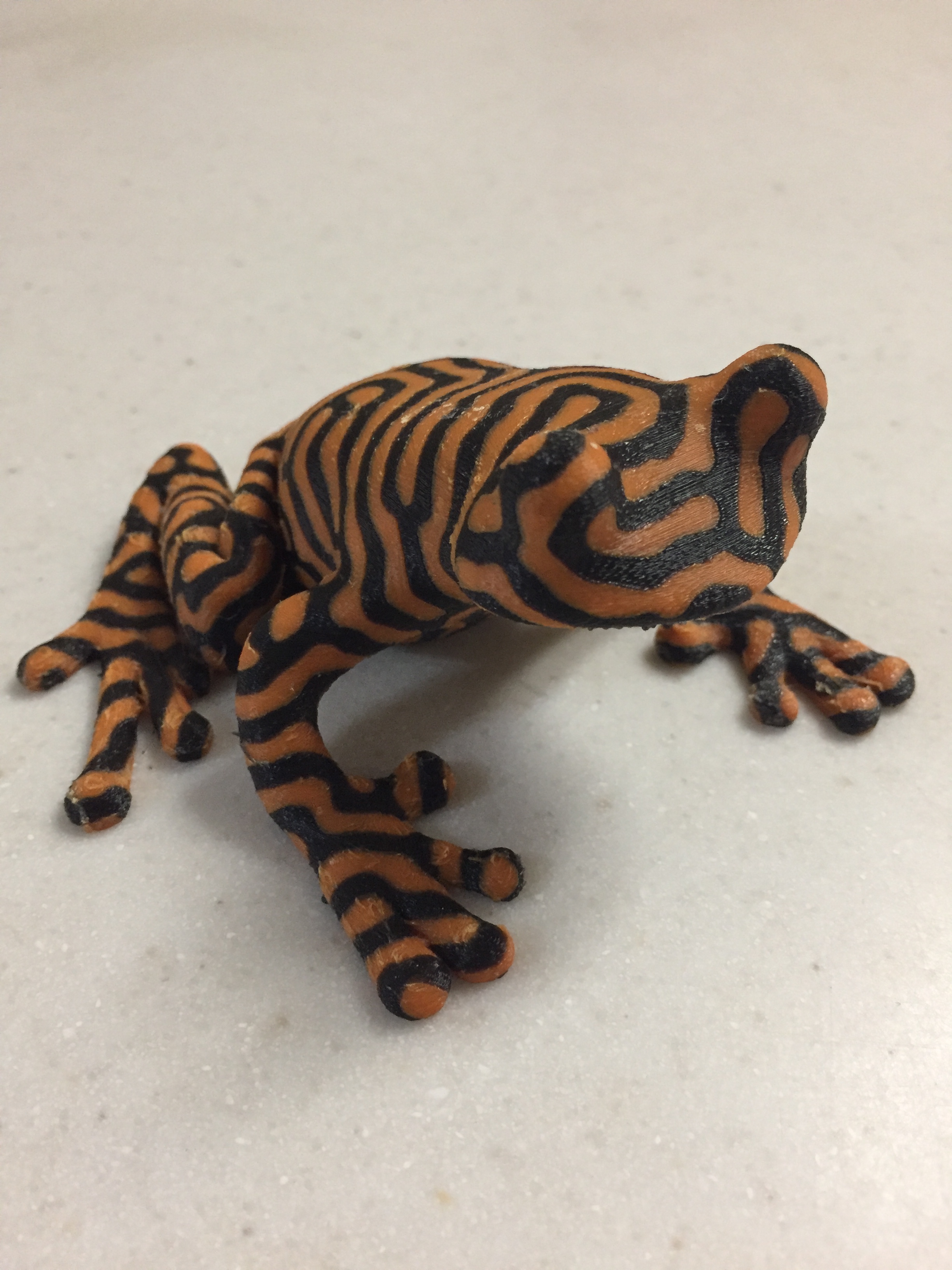

Here is my print of the dual color tree frog…
Using a ReliaBuild 3D Dual (RBB3 Dual) printer I printed this two color tree frog while demonstrating the printer at a recent convention.
Sliced in Cura 15.04.6 (newer versions of Cura don’t support RB dual printing like they used to) and printed with an ooze shield.
It was kind of cool to peel off the shell and see such a fine print waiting inside.
Calibrated the Black using these clips https://www.thingiverse.com/thing:1037301 and then did the Orange. Checked that the two colors of clips where interchangeable. Entered the calibration values into Cura and used this piece https://www.thingiverse.com/thing:2172438 to dial in the XY nozzle offsets. This frog was the result on the first try.
Not bad.
Brought him home and my daughter immediately claimed him as her desk buddy at work. :slight_smile:
