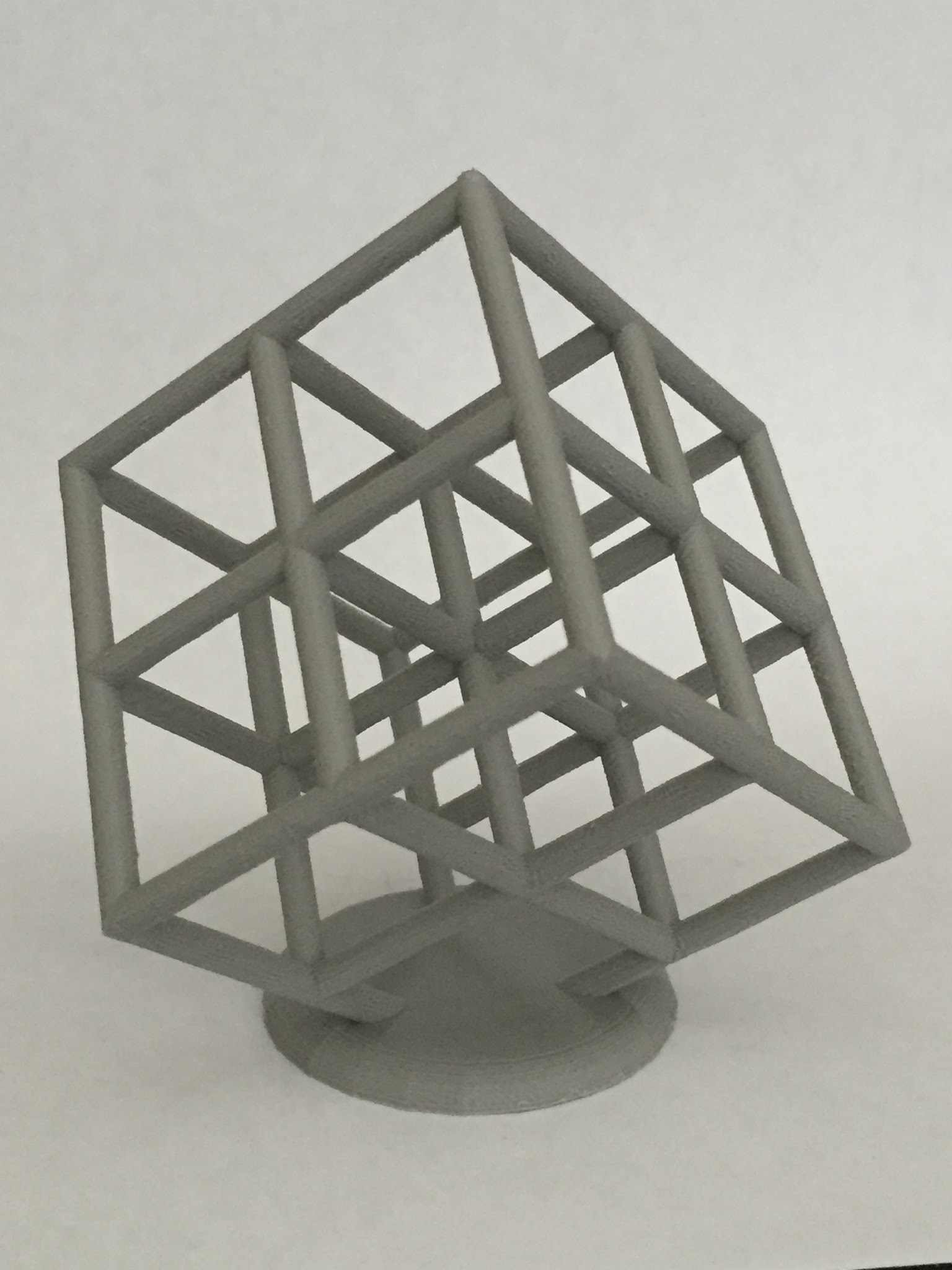

Don’t normally print torture test objects but I received this challenge and since one of my printers was idle at the time… I printed it.
75% scale, 0.1mm layers including the first one, 0.3mm nozzle and 0.9mm thick shells with 10% infill which made the lattice parts basically hollow.
No issues. Came out pretty nice. Fun print to watch build.

@Ernesto_Martinez Yes it was. Printed on my Rigidbot 2XL
The maker of the object was impressed. A major key to the success of the print is the extreme effectiveness of my part cooling fan and using 0.1mm layers.
