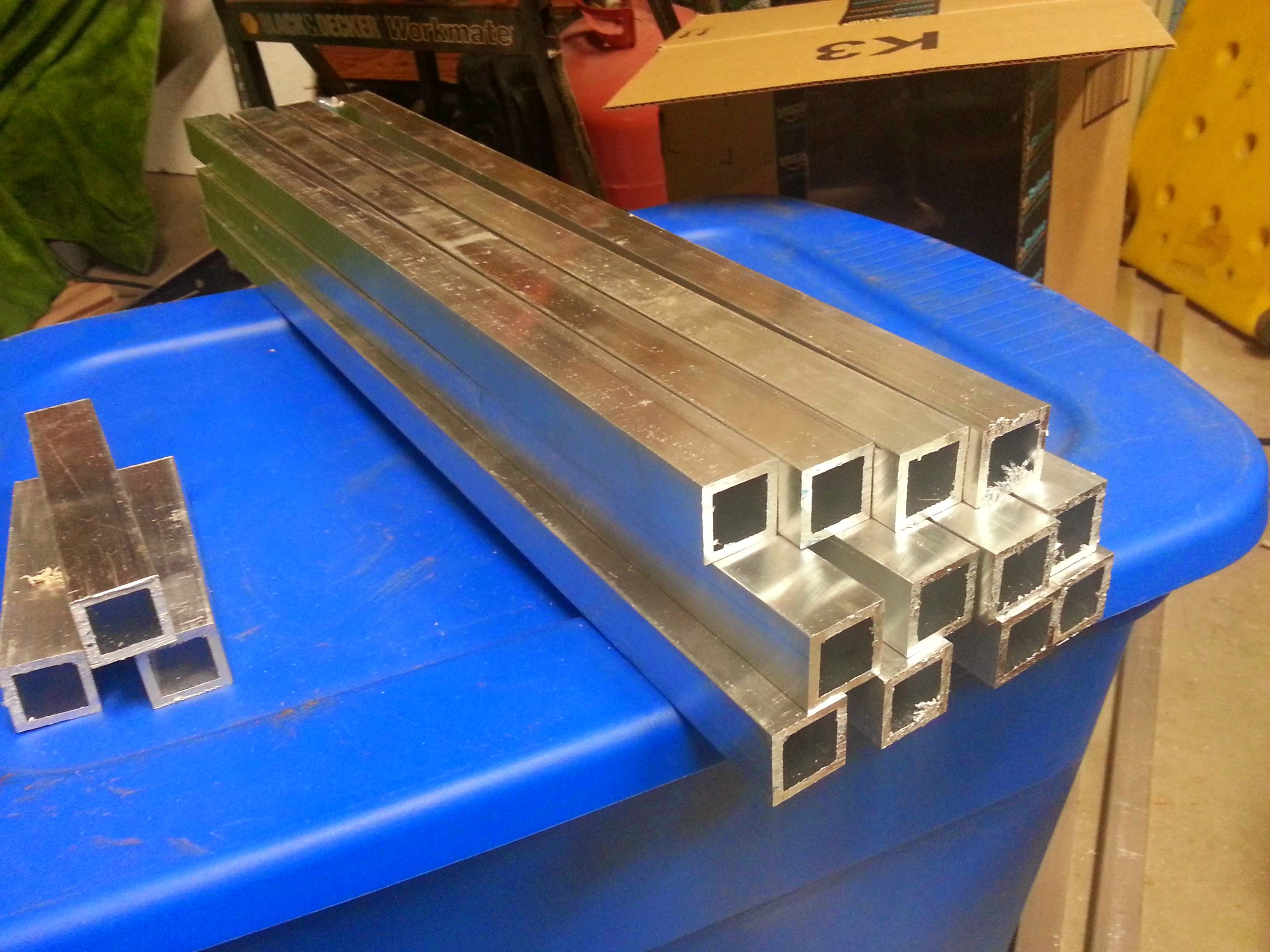

Shauki Bagdadi  Here is my saw and the twelve 24 inch tubes I cut
@Shauki Here is my saw and the twelve 24 inch tubes I cut from 10.5 foot lengths of tubing to make the structure of my quadstrap. I used a 60 tooth carbide-tipped blade and it cut right through the tubing. I’m working on the bolt sizes and quantities to match the available bearings so I can start drilling holes.

If you have a miter saw with e.g. a laser guide, you can cut those profile pretty precisely, with an accuracy better than a millimeter.
Is there any way to compensate for little inaccuracies like these?
I did setup a stop for cutting the tubes using some scrap lumber. I didn’t include that on the photo. The lengths of the tubes are almost exactly the same. I may touch some of them on the sander before I drill holes to make sure everything is square and even.
@Thomas_Sanladerer I found that 60 tooth blade is good enough with the aluminum tubing and is much cheaper than the 80 tooth multi-material blades. I haven’t tried cutting the plate for the stepper motors yet. It may be harder to cut since the surface is larger.
