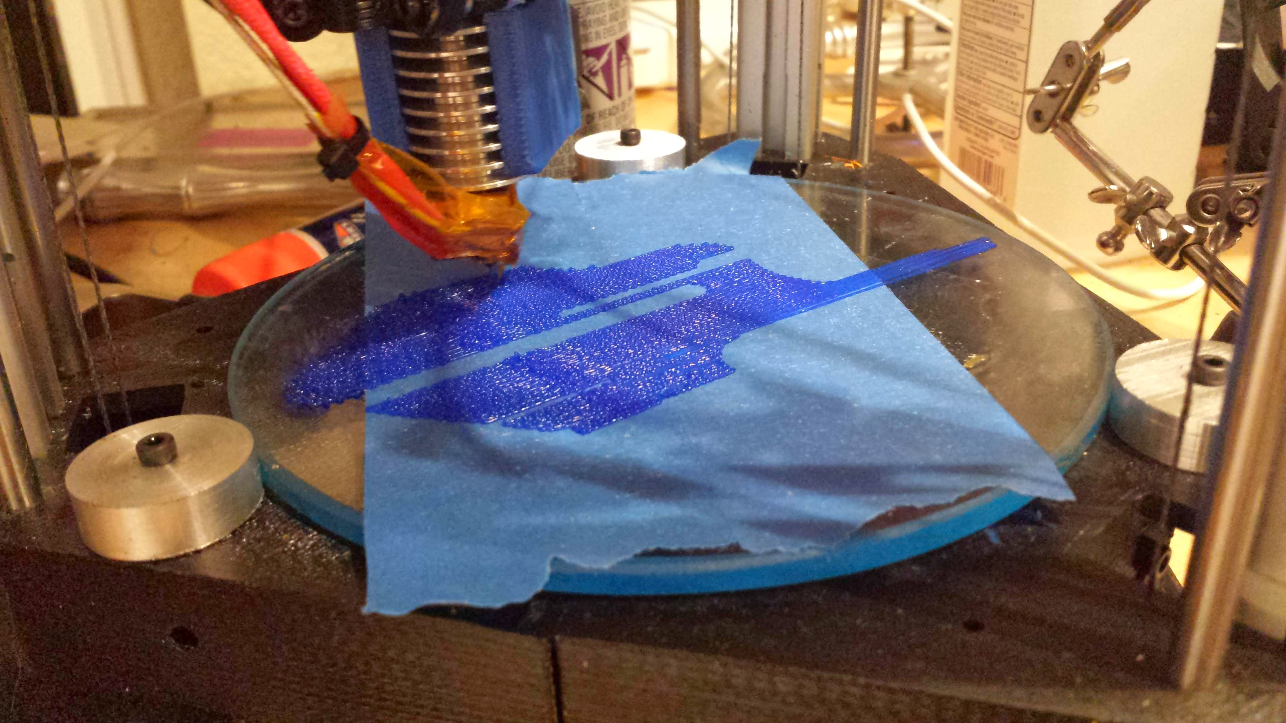

@Shauki inspired me to not quite be so freekin paranoid and just build. So I turned some spacers to hold the bed. Turned out pretty well, so far, and will make bed changes a breeze.
Next lesson learned: Round things SPIN. :smiley:
Nothing some additional tape didn’t fix.

Good idea! If you drill the hole off center you will be able to grip different diameters and snug them nicely.
I had been using spring clamps to hold the plate down. They smell bad when the extruder sweeps past. They scare the crap out of you when they jump off the plate (and ruin the print), and kept me from using those pressure sensitive sensors I currently have on order. The math called for 26mm disks. I made a 26mm one and two 27mm disks and things are quite firm. I’ll grind facets into the larger disks if I need to in the future, but I’m not sure that’ll be necessary. The spinning took me by surprise initially.
