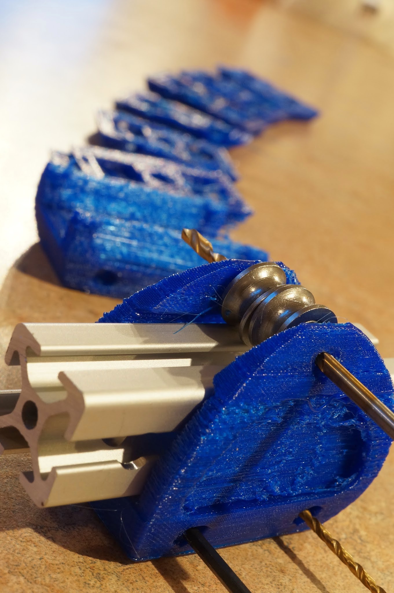

@Shauki this one’s for you.
I think if I’d been aware of this aspect of ‘rolling your own printer’, I might have stuck with a more developed kit…still, it sure has been educational!

I had been thinking of this since my Misumi arrived but with a v-roller bearing.
Boy do I know that feeling - but the parts are all reamed - fit and put together neatly now - all I need to do is sort out Repetier - or Marlin - or just make something work…
@Doug_Rector I’m in the same boat as you right now. Have everything set up and wired - need to start playing with marlin to get some movement and then calibrate.
Could you use the slots in the extrusion as a guide for bearings?
I’m pretty sure you could…these were just bearings I had laying about and not the right ones for the Job, @Shauki also surrounds the bearings in PTFE tubing to reduce the potential for wear.
Probably
I’d assumed the bearings were the only things supposed to do the touching…some PTFE sheet in there could be desirable to take up any misalignment and reduce friction.
