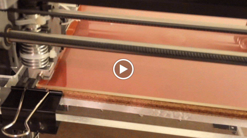

Shot glass in 3 minutes! This is about as fast as I’ve been able to print with the #Eustathios. I set it for a spiralized 10 sided cylinder with Cura at 200mm/s. Initial temp was 240, which was then increased to 270 mid-first layer. Layer height was .2mm. The limiting factor seems to be two-fold. The Rambo board has trouble pushing g-code fast enough if I use cylinders with a larger number of sides. At these speeds, I’m having trouble maintaining hotend temp with a 24v 14a power supply. Only downside is that I don’t think it’s a regulation shot glass.

This is one of the very first prints with the heated bed. It’s not the neatest looking thing I’ve ever built, but I’m liking it so far. I’ve just been using a quick shot of hairspray on the glass, and it seems to work well. I am running the bed on the same supply as the hotend, but I ran into the same limitation in the past before the bed was installed. I know the cooling fan is causing a good portion of the temp drop. I’m actually running a previous version of the carriage which didn’t do as good of a job at directing the air away from the heater block. I agree that the TinyG will be able to push things faster/smoother. Does anyone know if any slicers out there support arc generation (G2 or G3)? It sure would be nice if every curve wasn’t broken into tiny line segments.
