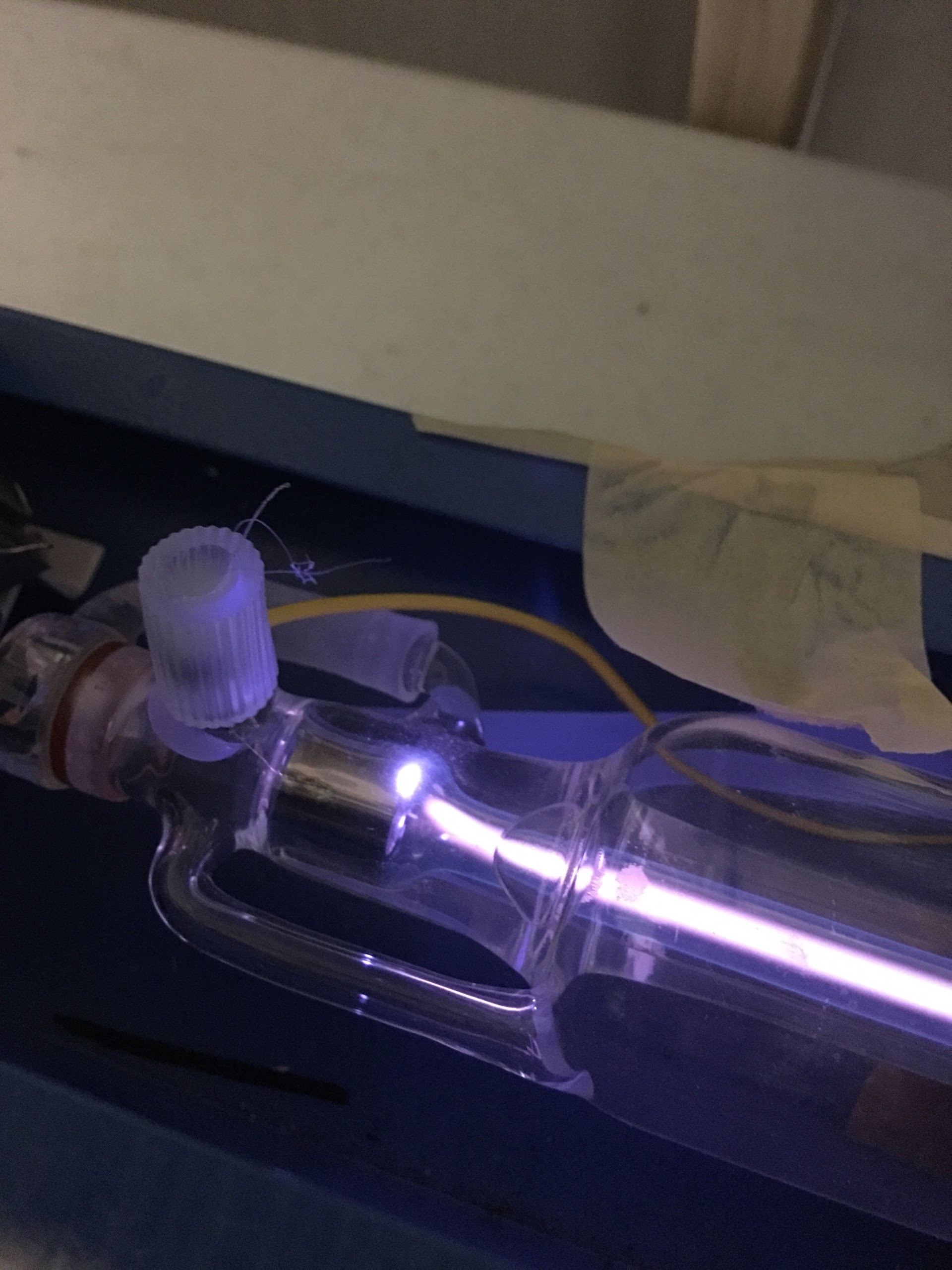

Should my tube be arcing like this at the end?
Should my tube be arcing like this at the end? All of a sudden my alignment is off and I do t know what went wrong it was cutting great and then nothing
Is that air I see in your tube?
A little bit it wasn’t there when cutting I removed the pump line when trying to figure out what was wronf
From what I can tell, looking for other pictures on the 'net - it shouldn’t divert like that. It should be rather evenly spaced around that ring. Waiting for others to chime in, I’m still learning too.
Yea I know it shouldn’t be I don’t know what is causing it
I’m thinking the tube isn’t grounded out my water is charged making it do that but I don’t know
is the machine earthed?.how many wire is on machines power plug
My water has a charge causing it to arc
