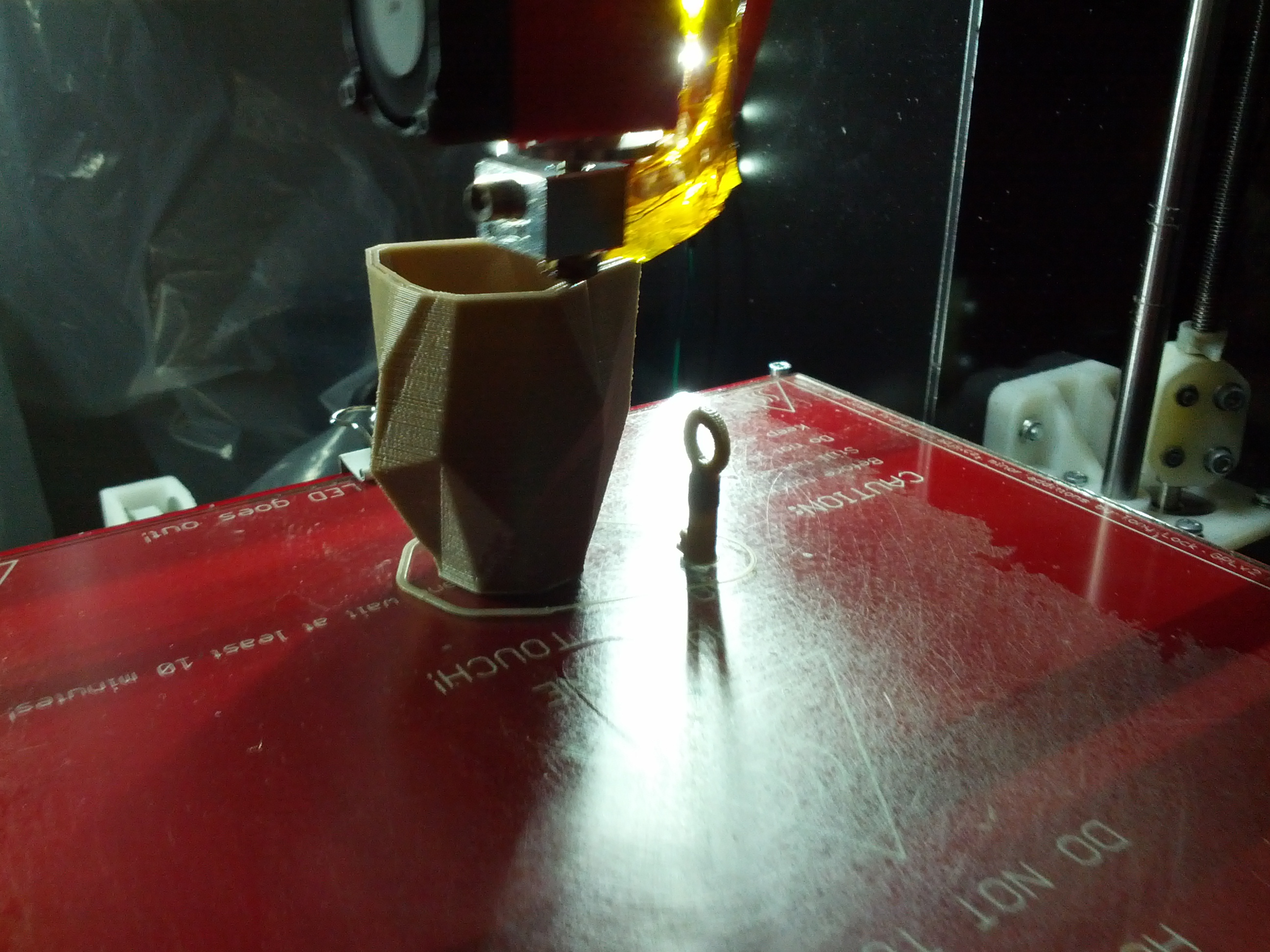

Printing onto a glass bed sprayed with hairspray, I got decent adhesion. The parts stuck for the first 8-12 layers, but then the corner of the triangular framing piece started to peel up. This eventually made the x-axis miss some steps, and I canceled the print to conserve the remaining 3 meter sample of Taulman 316 I have.
As you can see from the pictures, inter-layer adhesion is good, but the general surfaces produced are a bit sloppy. This might be over-extrusion, but as a lot of crackling and puffs of steam (or smoke?) came from the extruder during the print, I think the filament was fairly moist.
