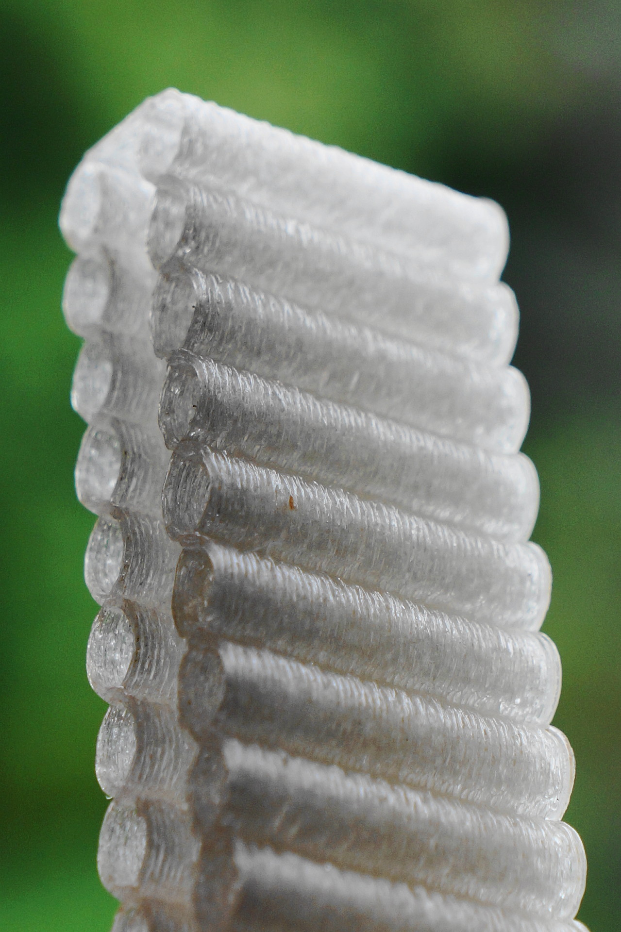

Sieb druck d193|17 it is possible to print a filter,
Sieb druck d193|17
it is possible to print a filter, this one is about ­∅150µm - fine enough to filter tomato soup.
This is also a single walled spiralized print, but 50% of the wall is on a different perimeter - which is why the holes are the result of layer height not a break within the filamentflow.
Nice :laughing:
I like the idea of printing customized filter.
Wondering what comes next.
Semipermeable membranes ? :sweat_smile:
This could be a good option for pre-filters for HEPA air filters too.
