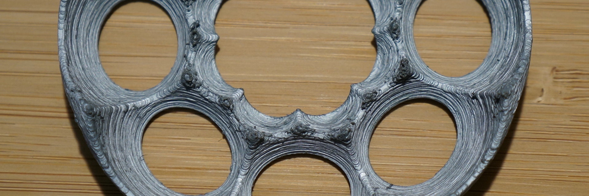

Silberschichten d146|17
100µm (0.1mm) layer, filament a lignin based bio degradable plastic - GreenTEC Silver
@Jonathan_Knirsch corrected thx…
@David_Sherwood just lost two prints due to warping (one on glas one on Kapton 80°C) so wouldn’t sign the zero warping - from my experience it is worse than PET-G but better than PLA. I like the BIO so it will rotten like wood if thrown away and I love that you can make objects that withstand cooking water / dishwasher. Also it is tough.
