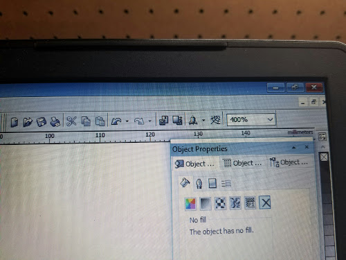

I did a system restore and that has allowed me to open it. Now I can’t see the launcher for engraving within CorelLaser though.
@Jamie_Lowe You will find an icon down near the clock in windows (may have to click the arrow) that will allow you to access all the CorelLaser features (cut/engrave/options/etc).
