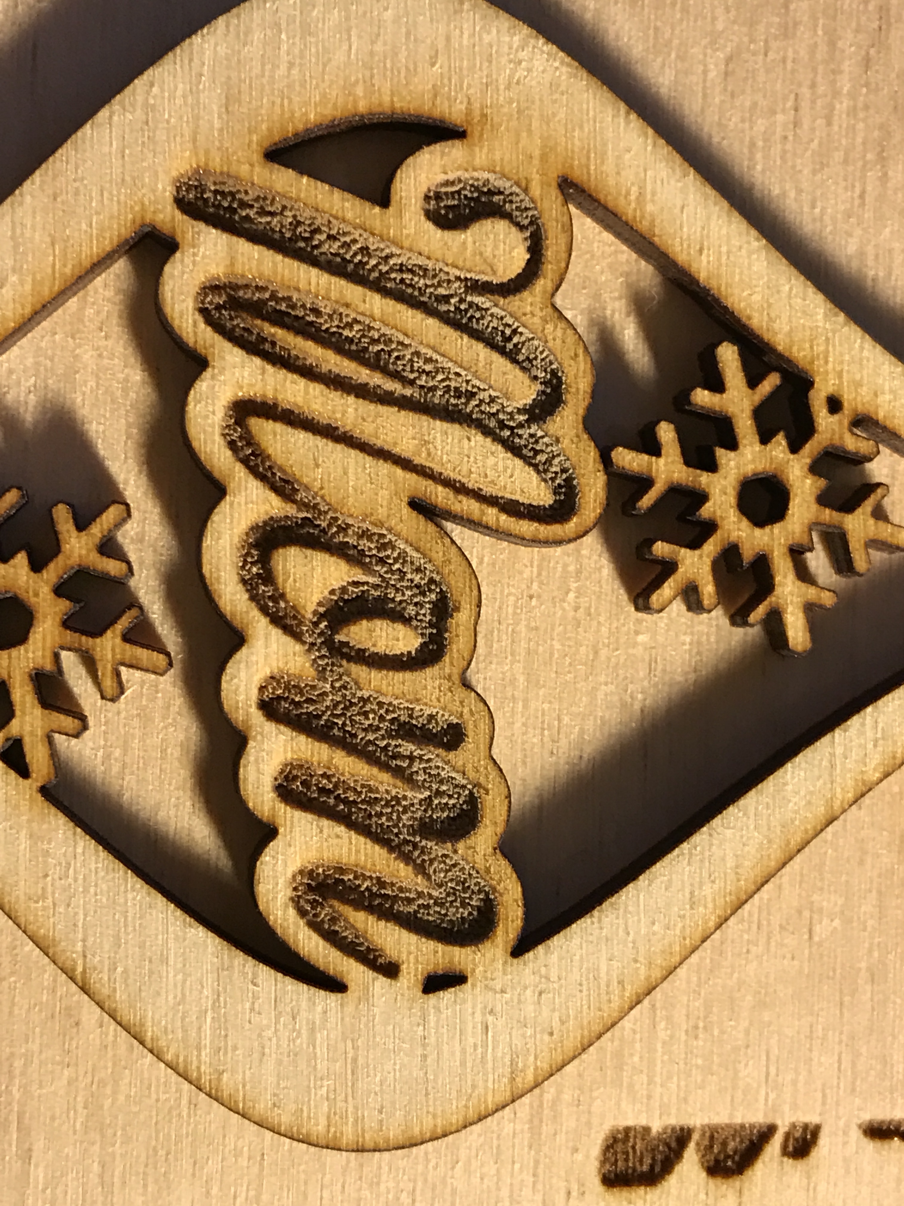

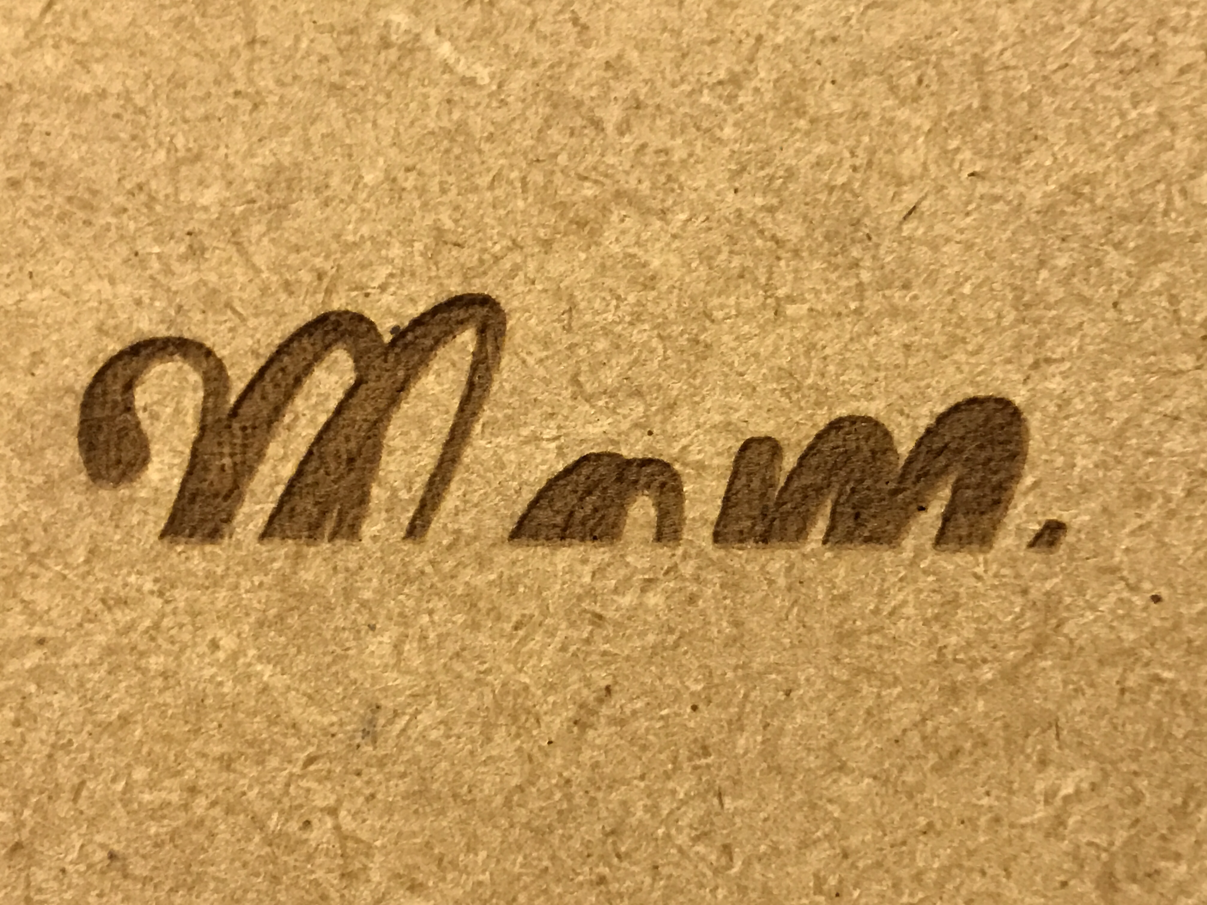

Since upgrading to the latest LW3 a couple weeks back, I keep getting grainy engravings on stuff that I’m doing sort of deep engraves with. I’ve played with beam diameter, and I’ve double and triple checked that my vectors are being exported as 300dpi bitmaps. This is done on birch ply, modded K40, with Azteeg X5, running the latest CNC firmware. The completed one was done 300/175, 7mA, the other was done 300/175 at 5mA. Beam diameter is .075 (had been .1) The homer looks pretty good. But none of it is really very deep.

I’ll give that a try as well. I moved back to .1 beam diameter (I had been trying .075 to see if it helped), and I get the same issue, just not as pronounced. The odd thing is that in all three photos it looks like a sort of leaning pattern.
In that last photo I reminds me of denim.

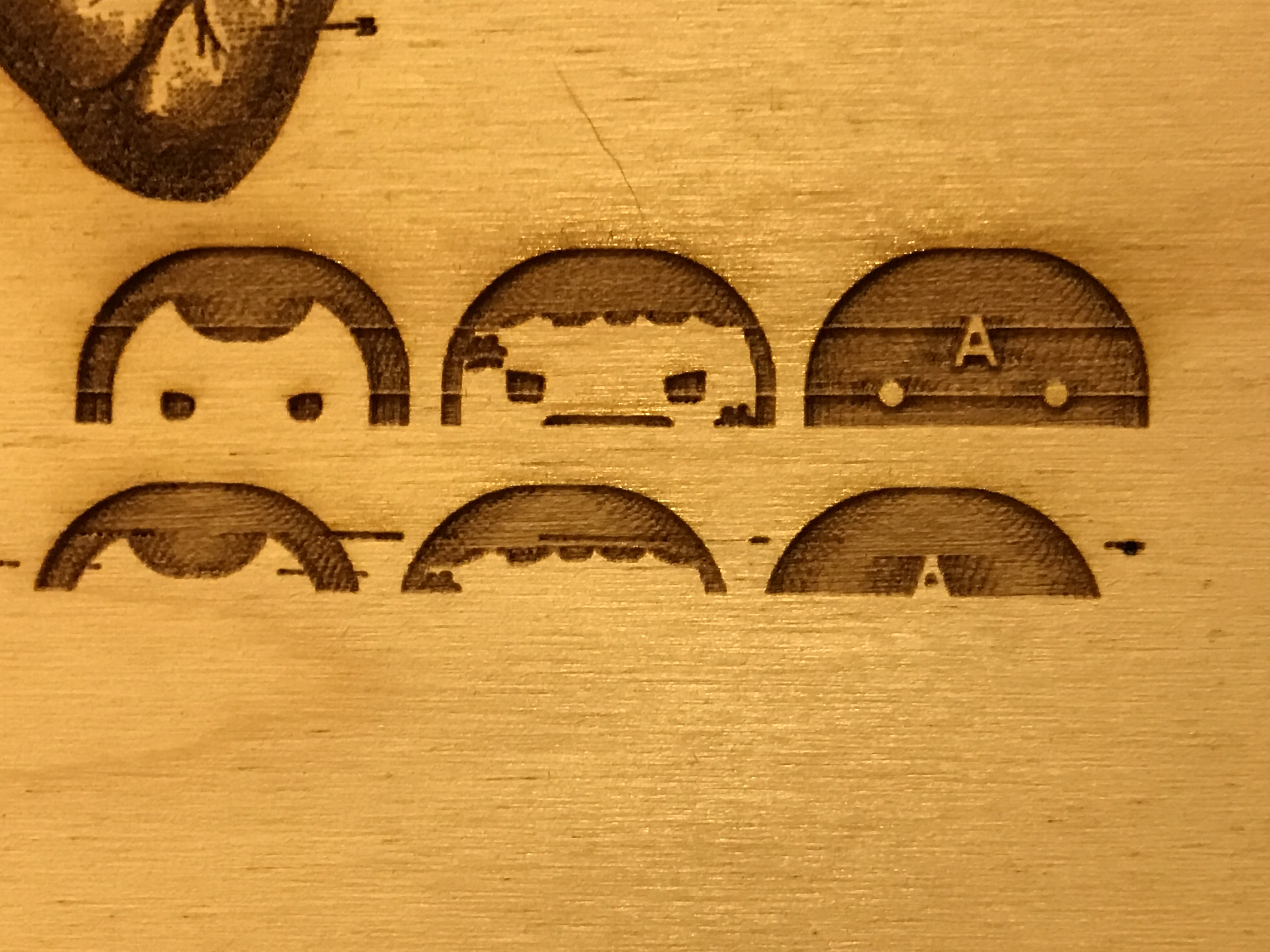

I did a big 3" circle, 100% black 300/300. What’s interesting is that the pattern shows up on the edges. Ignore the gap in the image. I opened the lid, which shuts off the laser. Prior to that I tried some small (1" wide) avengers icons. The photo is below. You see the pattern make an almost circular effect.
I should note that in both these images I have concatenate x turned on.
