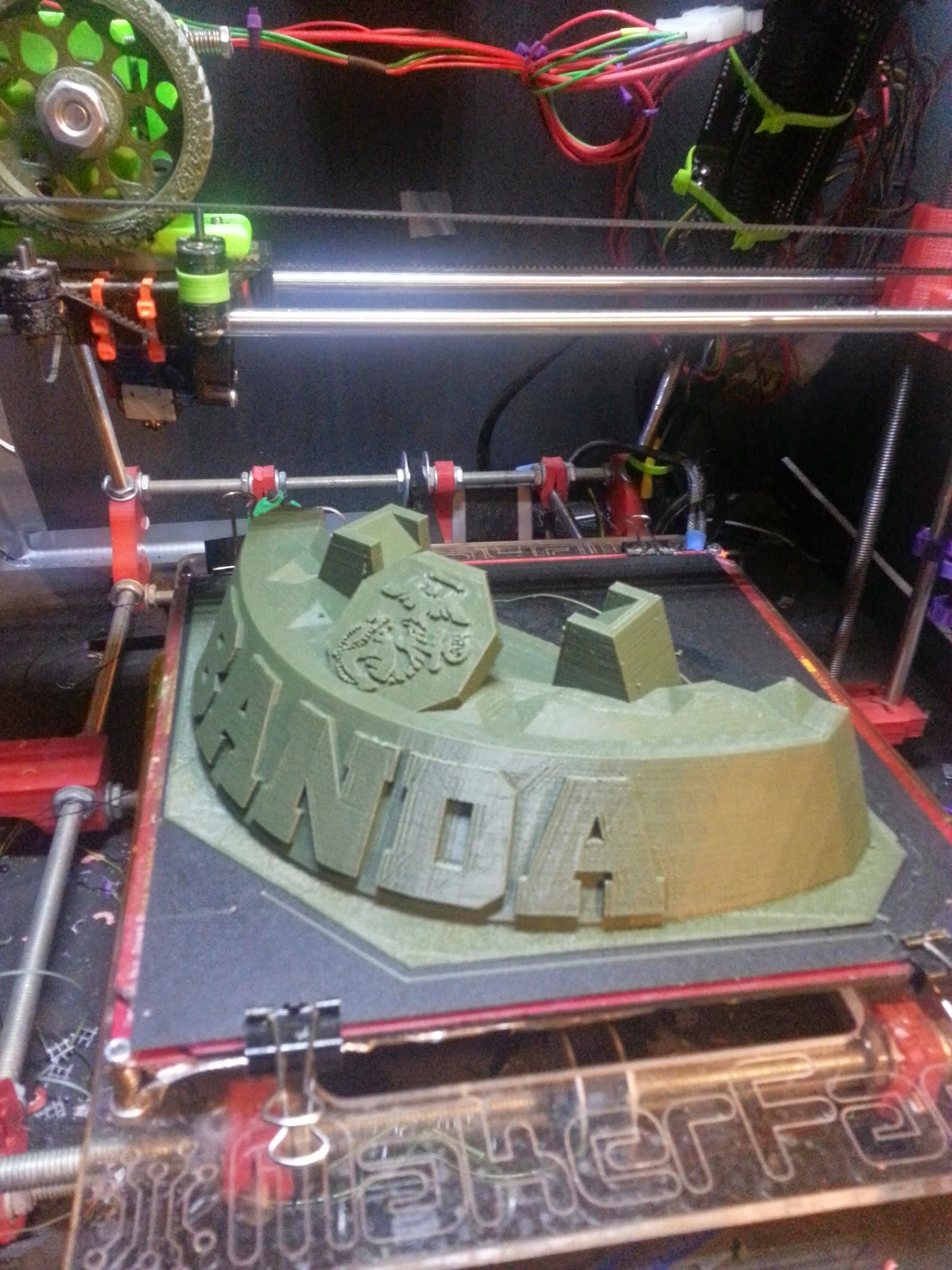

Single largest print to date.
Single largest print to date. First attempt failed due to one corner lifting horribly and I was at work so I couldn’t stop it before it finished wasting a LOT of plastic. This one however came out dead flat after re-leveling and adding a better brim to the model.
3yo Prusa i2
Ultimachine Olive Drab 3mm ABS
E3DV6 .4mm Nozzle
240c Nozzle
100c Bed
Buildtak adhesive surface (Love this stuff even if it is expensive)
50mm/s
Cura 15.02.1
Looks like a memorial stand for a marine, possibly to display a medal? Would love to see the final display.
Yeah agreed, looks great but clue us in on what it is. Semper Fi.
Sorry havent been paying attention to the comments. Its the base for a name plaque for a desk or wherever. I sell tyem to coworkers and a few here and there on etsy. This was a special request for a giant version of my regular small plaque. The slot in the pillars accepts the rank insignia.
