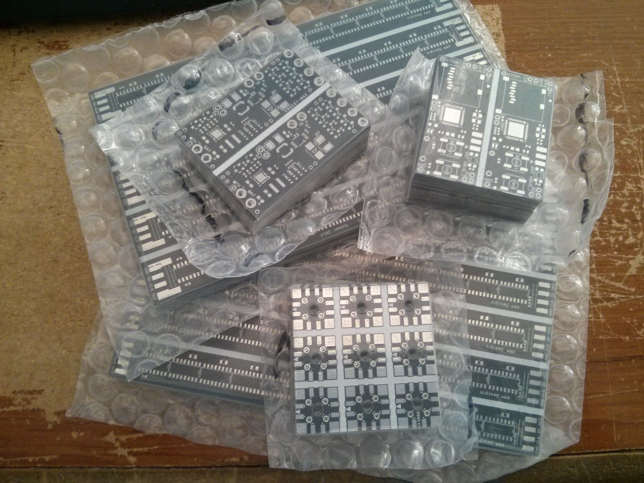

So I sent in five boards to be made. Three of them were 10x, and two of them were 5x. This is what came back:
14x on controller module
12x on power module
12x on filler
5x on wide strip
7x on thin strip
This is what happens when they need to fill a full sheet for processing.
Ha! Who’s you use?
iTead. Files were sent 9 days ago. DHL notified me yesterday the package was leaving HK at 6:45pm … was at my door at 1pm today.
