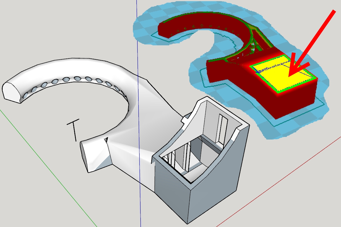

Sketchup is a pain! I've been drawing a new cooling system for my Anet
Sketchup is a pain! I’ve been drawing a new cooling system for my Anet A8 and it wants to print a wall in the middle for no reason. Could someone take a look and see what might be going on? Both Cura 14.07 and 2.3.1 try to draw it.
I learned tonight that slicer programs choke on reverse faces. The white/grayblue represent inside and outside surfaces. So I selected the areas in question, right clicked and use the reverse or orient surface command. Now everything is printing correctly.
